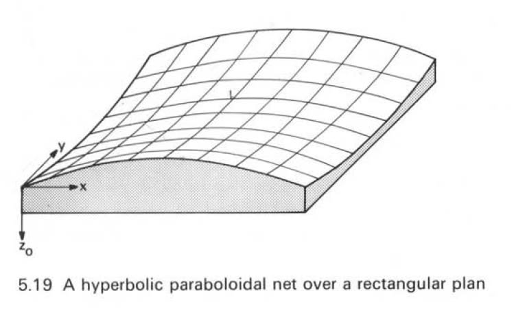

The overhead view of the roof surface suggests that that might be (probably is) a shallow hyperbolic paraboloid surface. They work well at spanning large column free areas and are a fairly light roof structure. The support systems, walls, buttresses, etc. should give some hints as to the structure. The school, or the municipality should have some plans or know who the Arch. or SE were.

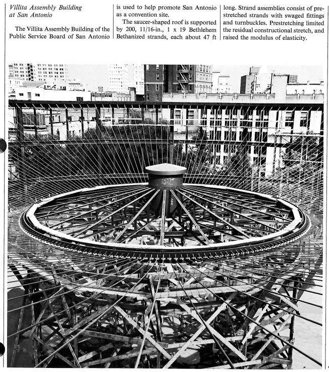

This might be some type of cable tension structure - possibly similar to the La Villita Assembly Hall in San Antonio, Texas.
The one photo you show suggests that the perimeter eave has a concrete beam that would serve as a compression ring with cables (internal to the concrete?) providing some type of catenary tension support for the main roof area.

see Cable Structures by H. Max Irvine page 223

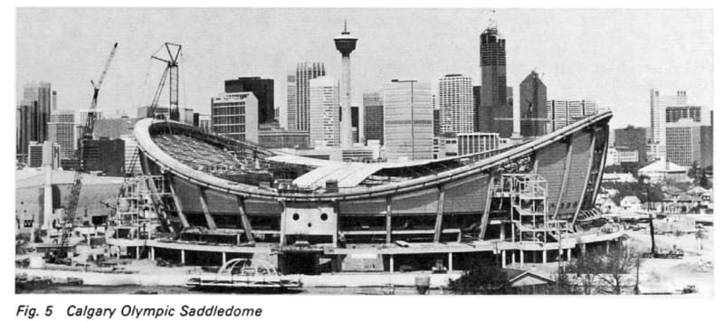

Also found this roof detail for Olympic Saddledome, Calgary (Alberta)
Link
