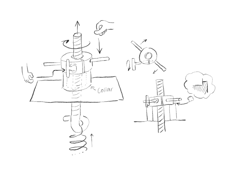

I had an idea of making a collar to prevent thread contact with metal sheet, but this requires a spanner.
background: Wing nut was used because there was a complain about the v-belt coming loose and operators in the plantation are unable to adjust the belt due to a lack of spanner. So wing nut was selected due to convenience in adjusting belt tension.
I'm sure this invites a lot of criticisms and ideas because, belt tensioning and hand turning doesn't go hand in hand. If you have a better idea, I would love to hear.
For now, belt tensioner was fastened with wing nut, spring washer and common washer with a spanner. But I don't have a convincing enough reason to the team as to why we need to use spanner to fasten the stud other than to prevent loosening/vibration damage to the stud.

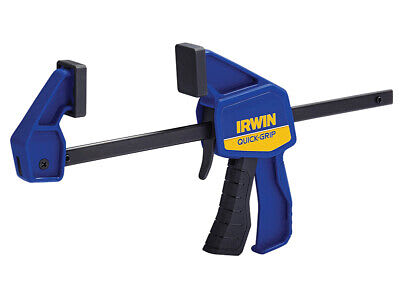

An adaptatation of a caulking gun trigger/ratchet, or trigger clamp?
Plastic is a concern.. as it is subjected to warm temperatures and possibility of degradation.
dvd said:
Adapt a turnbuckle to provide push/pull - an anti-rotation bar could slip into the body to prevent turning after adjustment.
you mean a turnbuckle with a handle/ratchet?
dawz your proposed designs seems quite reasonable.
Pros:
1. Cost
2. Simplicity
3. Ruggedness
4. Access completely from one direction - topside/operators' side
5. Minimal change to existing design and corrects the known failure mode.
6. Gets rid of the underside wingnut, thus eliminates the need to access a wing nut on the underside of the console.
Cons:
1. Tool (spanner)required - but the tool is a common wrench (spanner)
I think your design change is good. I suggest you skip having the wing nut welded to the spacer collar. No benefit gained and this collar can free float with the wing nut to provide accommodation for assembly variations.
dawz Actually, I think I see why you are proposing welding the collar to the wingnut - to eliminate wear on the threads of the rod due to vibration and contact with the structure. I was envisioning the collar being bronze or brass.

Brian, indeed I was trying to space out the threads so that it doesn't vibrate with the metal sheet.

If you need it to be secure use a threaded shaft collar and replace the included socket head cap screw with a thumb screw or T bolt.
Example:
Shaft Collars, for 3/8"-16 Thread Size, 303 Stainless Steel
Using TugboatEng's suggestion of a threaded shaft collar with a T-bolt or L-bolt replacing the OEM cap screw with your spacer collar with a topside wingnut might get you a solid spanner free solution. If the operators have a convenient and secure belt tension adjustment mechanism maybe the belt life will be improved.
Your spacer collar protects the threads not in engagement, the wingnut and threaded collar allow quick adjustments without needing tools. Looks pretty promising . . .
This is a good idea. I imagine it having wings on the collar. Adding T bolt, it will be 100% spanner free. Collar sits on another collar to prevent horizontal movement during hand turning, and T bolt locks it up.

Yeah, indeed that the wing nut grip length is short, and yes to the bushing preventing thread to come in contact with the plate as well. Spreading out wing nuts as in increase the wing grip length? At the moment, it needs to keep the stud or wing nut "locked". Pulling up the spring by turning the wing nut alone is not a problem.
You may even be able to use the T-bolt as the handle so you don't need additional handles.

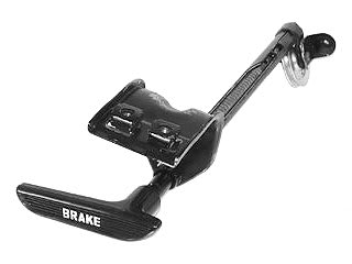

I've been thinking about this since the start of this thread, but just found the picture.
MJ, that brings back memories - specifically that if one pulls on the left end of that at all it fractures the plastic. It looks like the FoMoCo part in a car I owned for a while. It arrived broken.
Not sure what the cure for this problem is - the wear is because the threaded rod came loose; if it isn't clamped and is always loose under spring tension it will chew itself and whatever is nearby. I don't like the idea of reaching underneath to manage a jam nut, but a jam nut and a nut tightened with a wrench should be enough to hold the rod from getting loose. But if someone fails to do that there isn't enough tension from the spring, plus the spring adds mass to the end of the rod to cause it to oscillate in rotation and chew itself or neighboring parts up.
I would try to make the spring longer so that it never needs adjustment; idlers on serpentine engine belts with far more pulleys manage to have a one-time windup. If there isn't room vertically, see about a bellcrank to direct a spring in some other direction and eliminate adjustment entirely.
