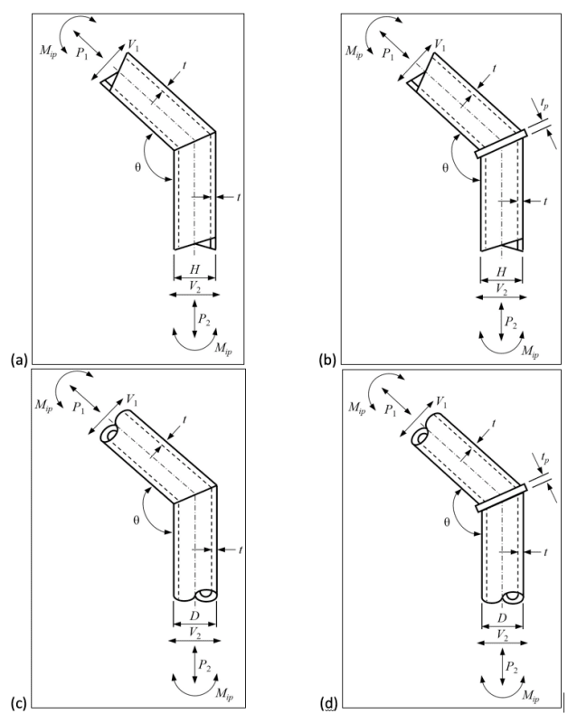

Hi all. I'm looking at a steel pavilion for a friend and am looking for some confirmation/guidance. I mostly work with wood-framed structures so this easy project is challenging me more than it probably should. As you can see below it is a pavilion with 3 steel a-frames/bents/cranked beams, whatever you want to call them. I have modeled the center one in Risa. It will be built with HSS tubes that weld together at the peak. My sketch below shows the pin and roller supports, the point loads from the purlins that hang into the a-frames, and the reactions at the supports. Here are some questions I have:
- Does my diagram make sense with the pin and roller supports?
- Does the 83 kip-ft moment at the ridge sound reasonable? I don't ever use Risa so I'm not sure I've modeled this correctly.
- How can I show that the full-pen weld at the peak can handle the 83 kip-ft moment?
- Any additional feedback would be appreciated
Yes the pin and roller makes sense.
The apex is a definite weak point. Simply writing "full pen weld" isn't really enough in my view for such a critical weld.
Also, a mitre cut butt-welded HSS is prone to buckling, because the flange bending forces have nowhere to go except the side walls. You need stiffeners, or end plates, or something, to ensure the webs don't cripple.
Personally, I'd be welding a triangular stiffener into the underside of the apex joint, cut from the same section. Same concept as a haunch.
For the mitred connection I'd use a flat plate twice the wall thickness and fillet welds with throat thickness >20% the wall thickness.
This would be easier and faster than a mitred connection.
Tomfh' suggestion of a collar tie likely would improve capacity but you have now given yourself connections that are more challenging to analyse.
Suggested connection shown on right.

It is also necessary with high moments as kinked beams cause weak axis bending of the top and bottom flanges of the tube at the joint.

A conservative shortcut is to try to get the job done using only the welds on the HSS side walls. This will underestimate capacity but is simple to do. Once you try to exploit the HSS flanges, things get more complicated with respect to the amount of flange that might be able to be mobilized without stiffeners etc.

I haven't read every response and I don't often design connections like this, but I doubt anybody is saying that. You should be able to calculate the capacity of any connection per AISC. If, for example, you were to add an end plate sandwiched between the two pieces at the ridge with fillet welds to each piece, you can definitely determine the capacity of those welds and use that to then determine the moment capacity of the overall connection. You can also determine the capacity (or minimum thickness) of that end plate. I'm guessing that most people might use basic rules of thumb in connections like this. Like if the weld is of a sufficient size to be of greater strength than the axial capacity of the HSS wall, then there's no need to provide a more in-depth analysis.

I think that's an accurate statement as far as unstiffened moment connections go. It's a pretty common thing for designers to want to do this on smaller applications but, to my knowledge, there is no industry sanctioned design method for dealing with it. A great many dog legged stair stringers are examples of this in my experience.
I think stair stringer can be checked, you are just checking something similar to panel zone shear in the web. The HSS is harder because of the weak axis moment in the "flanges".
My main concern with the system as you've detailed it is that it will be quite flexible. Given that you have cantilever columns, you also likely can't call it pin-roller supports, unless you use a roller, in which case I think the roof might roll off the support under snow load.
I disagrees on the channel stringers. Channel flanges also have the weak axis moment problem that you described. An HSS bears considerable similarity to a pair of toes in channels after all...
Ok, I suppose that is true, the centroid of the flange is eccentric to the web, so there is some flexure that needs to occur somewhere. Given the smaller eccentricity and the fact that stair stringers rarely work that hard it might be more rational to ignore it than in this case though.
