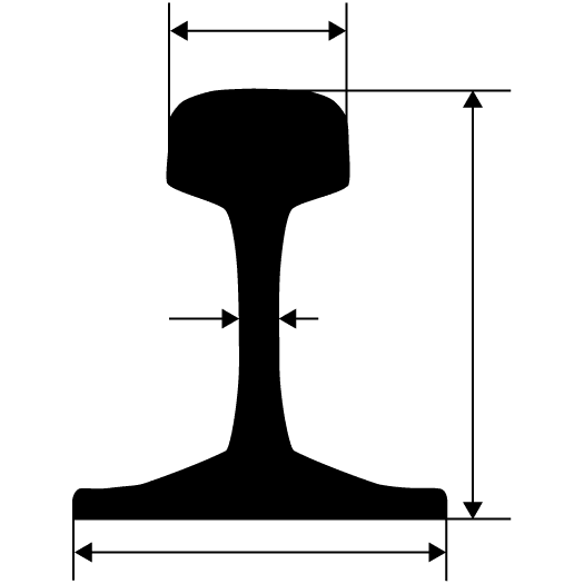

I am working with the artist who wants to create the installation of 52 flagpoles that are approximately 23 feet high, and for conceptual reasons, wants the flagpoles to be made out of the old railroad rail. The installation is to be outdoor (for DesertX biennale) somewhere in Coachella Valley where winds are quite strong.I hope that I can get some guidance from the community here. Thank you!

@swcomposites Thanks for the suggestion but the whole point is to actually use the single rail in place of the traditional tubular flag post retaining its singular visual characteristics. I wonder if 25 foot section of rail can be a stand in for the flag post ( with possible modification to the section imbedded inside the concrete foundation).
What guidance do you need exactly? Material properties of the rail, how to analyze it, what risk category it could be, would you use temp ASCE 37 loads or ASCE 7 loads?
@canwesteg Precisely that: Do material properties of a recycled rail (exposed to years of repeated stress) make it appropriate to use as a stand-in for a flag pole in the windy area( 20 second sustained 103mp/h wind gusts). This will most probably be temporary installation for 11 weeks, so I would think that ASCE 37 is the category. Thanks for your response. ( I just noticed that this forum is for Engineering Professionals. I am a production director for DesertX biennale with no engineering background, seeking some advice. I apologise if me being here, asking questions is against the forum's rules and if so I will leave promptly)

Rail is not even and responds to bending in different way depending on the direction of force. The issue being is that the wind changes direction...
And rails are not even shaped. Does the artist want them all in the same orientation?

Not going to look into it, but I wonder what the torsional vibration modes of this shape are, and how these will respond to wind-induced vortices. Also wonder whether putting a pipe section at the top few feet would make this more torsionally rigid.
added comment - it would be pretty cool to come up with a shape/length which would oscillate intentionally, maybe a couple of different frequencies over a realistic range of wind speeds.
