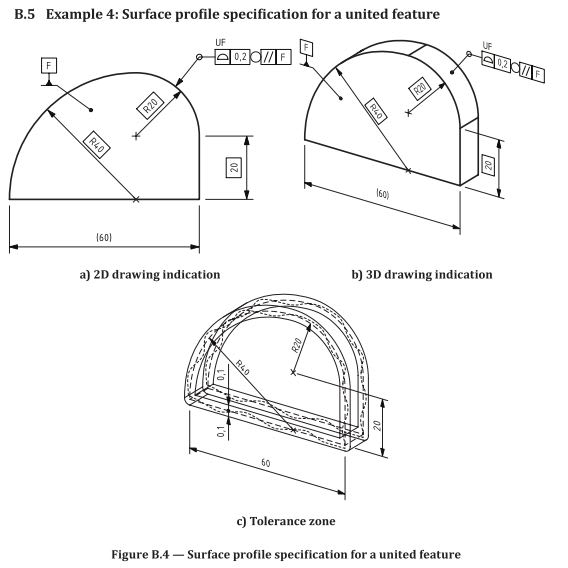

ISO GPS system:
Can UF and collection plane be applied together?
(UF above the tolerance indicator and collection plane as a supplemental indicator)
I don't have access to all ISO GPS standards, but in the ones I have I cannot find an applicable example where UF and Collection plane are used together.
Is it feasible? Is it legal? Any good examples?
Thank you so much and have a great day/ weekend

Should I understand that if the closed contour features are external then collection planes supplemental indicator is needed, but if the features are internal the collection planes is not "a must"?
There is no such rule.
The rule in ISO 1101 is that the collection plane indicator shall always be specified for all-around callouts in 3D definitions (MBD), but it's optional in 2D.

In ISO, all-around doesn't group the features, at least not in the sense of fixing the tolerance zones to each other. It only indicates which surfaces are controlled for by the tolerance, but without the datum-related constraints, the limiting zones can be disjointed (controlling each surface's form separately).
In 3D, for a simple rectangular block with a square hole passing thru a pair of opposed wall, applying profile tolerance all-around to the external shape without additional indication leaves room for ambiguity as to which 4 outer wallsof the block are controlled by that tolerance (of course if we forget that the object associativity exists and can be easily leveraged to eliminate the ambiguity).
However, for the square hole, I don't see a point in using the collection plane indicator in conjunction with the profile tolerance as there is just a single choice possible.
Neither the all around symbol nor the collection plane indicator is the tolerance zone grouping mechanism in ISO. In frequent cases, even the existence of datums may not be enough to group the tolerance zones entirely.

I guess you can call it an oddity, but the meaning is not the same as a datum reference inside the tolerance indicator (feature control frame). The profile zone in the example above is not enforced to be perpendicular to datum F. The collection plane is only used to identify the features that "all-around" applies to (the features intersected by a set of planes parallel to datum F).

"The profile zone in the example above is not enforced to be perpendicular to datum F."
Ahh, it can be a millionth of a degree to datum F, smeared at an angle and millions of meters wide?

"Ahh, it can be a millionth of a degree to datum F, smeared at an angle and millions of meters wide?"
The tolerance zone can be fitted to contain the as-produced surfaces. it's not required to be 90° "theoretically exact" (basic) to datum F.
As for the "grouping" by the collection plane, it is just for identification purposes, based on the nominal geometry. It doesn't establish a geometric relationship between the tolerance zone and the datum, or between the surface elements forming that shape.

The intent is that regardless of where you put the tolerance indicator - whether it's on the 2D view on the drawing, in the notes section of the drawing, on the 3D model, or on a supplementary document not depicting any part outlines, the all-around requirement is interpretable, that is - you would know "which way" is all-around.
I'm not saying it's a good idea (actually I think it sucks), but that's what ISO has now.
If it is unrelated to datum F and cannot be related to datum F then why is datum F mentioned at all?
As I said, "it is just for identification purposes, based on the nominal geometry". Meaning, any surface nominally intersected by any plane parallel to datum F is under the all-around control. However, that doesn't constrain any degrees of freedom or the tolerance zone to datum F. Messed up? Yep, it sure is.

First, it is redundant—especially for MBD. MBD standards such as ISO 16792 and ASME Y14.41 require geometric tolerance annotations to be associated with the features they control. For example, when you click on the feature control frame, the associated surfaces are highlighted. On 2D drawings, it is also redundant. The view in which an all-around callout appears makes it clear what it applies "around".
Secondly, the callout is long and, as you mentioned, complex. As you can see from this discussion, the unusual use of a datum reference causes confusion about what the datum does. Which means it can easily be misinterpreted.
If the front surface is not parallel to F then it is also collected?
