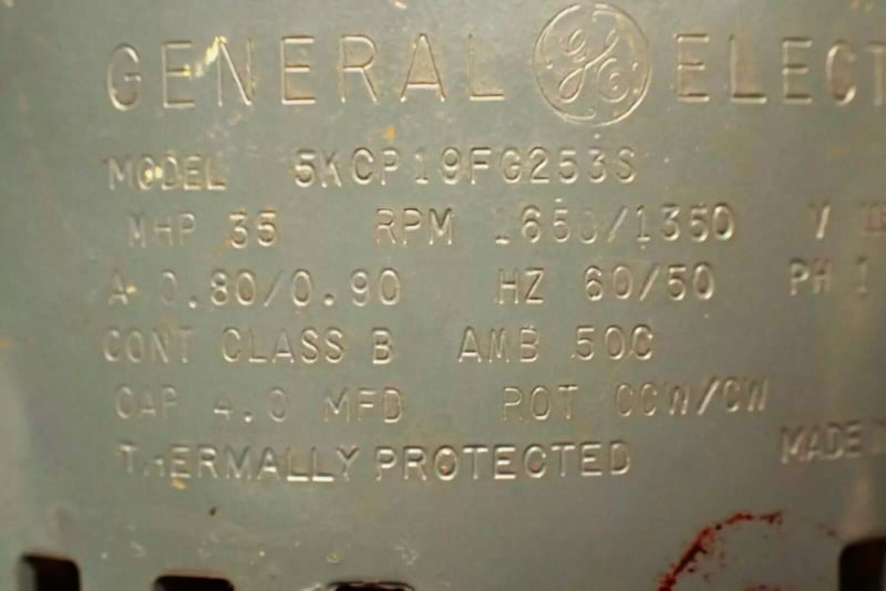

I picked up an old GE 5KCP19 motor and it has a five wire connection. Metering the leads, the continuity values are as follows.
Bk-Wht. 0
Bk & Wht-Red 92
Yel-Blu 17
Motor Ratings…
115V, 1650/1350 RPM, 35 Mhp, Cap 4Mfd. CW/CCW

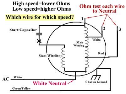

Yep, read that one but there are no specifics, just guesses. I’m assuming the higher resistance reading is the main winding, the lower the accessory. I’m somewhat confused about the shorted Blk/Wht reading.
Uhhh. That thread is for a two speed motor, this is a single speed motor with 150 RPM slip.

According to GE nomenclature (5KCP,) they are permanent split phase units.

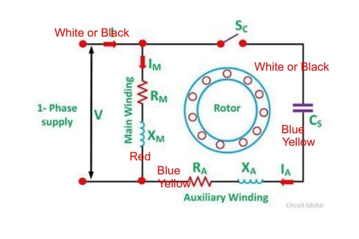

OP,
Just going on process of elimination and the resistance readings. If you are sure there is NO centrifugal switch, then white and black are interchangeable and can be either line/N or cap. Red is the other side of your main winding. Yellow and blue is your start winding but since you don't know the direction, its a 50/50 to what direction the motor will spin. So either yellow and red to line/L and blue to cap or red and blue to line/L and yellow to cap.

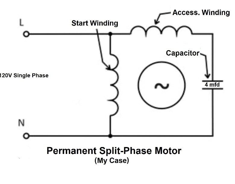

The 5 in the 5KCP19 just means that the model number belongs to a motor. The KCP means that the motor is a Permanent-Split Capacitor type. The 19 indicates the frame size (a GE assignment, not the NEMA size number).
It's a PSC motor, so there would not be a centrifugal switch. Color codes are specific to each manufacturer, so unless you can find an original installation diagram from GE, who is now out of that business and no longer exists, you are going to have to figure it out on your own.

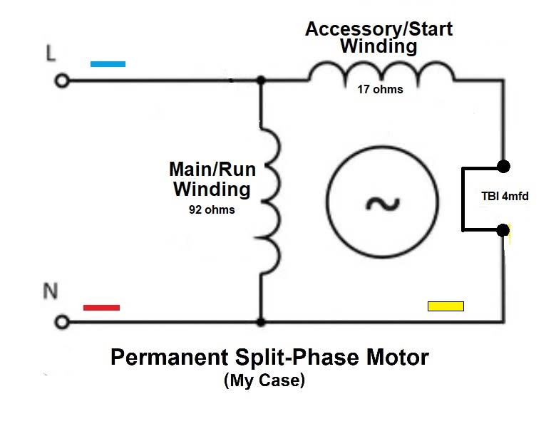

While I'm waiting for the 4mfd cap I made some progress...and understanding.
The accessory winding (also called the start winding) is actually the lower resistance.
The main winding (run) is the higher resistance one.
By applying AC to yellow and blue and adding a little spin of the fingers in either direction to the shaft,
I get rotation! Adding the red and yellow together don't provide any discernable increase in speed with the main in circuit.
Note that the cap is not installed, just running straight wire.
