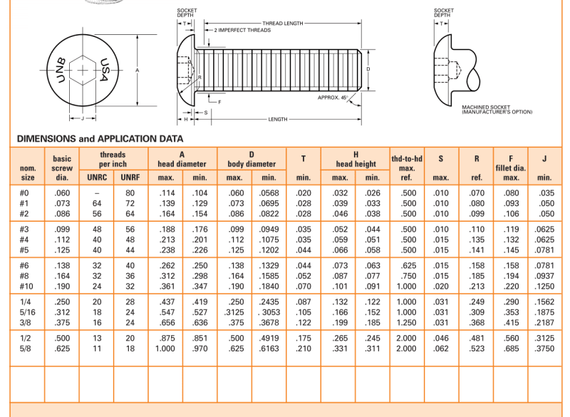

Hi, I'm hoping someone can point me in the right direction. I'm working a tolerance stack to make sure at worst-case that a button head screw cannot protrude past the sloped countersink of a part. The problem is, I cannot find the specs/dimensions of the radius'd portion of the button head of the screw or where the radius stops at the top of the head. Spec ASME B18.3-2012 shows the min/max size of certain features of the screw, but nothing the radius.

Having said that, here's the button head page from my vintage Unbrako catalog. It has radius "R" of interest shown as a ref dimension.
