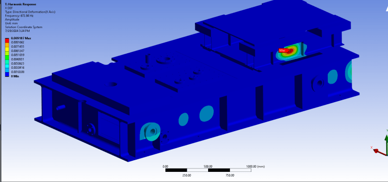

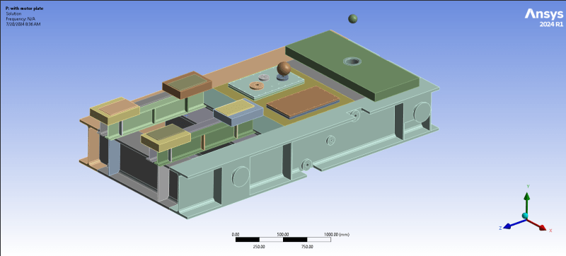

Hi. i have ran a modal analysis for an integral gear 3 stages compressor skid. the speeds of two rotors are 29121 and 42460 rpm respectively and motor speed is 3000 rpm. but the results was disappointing, there is almost 40 natural frequencies in the range of 10 percent lower and higher than rotors speeds which is not acceptable based on API. did anyone have the same problem? what should i do now? this amount of frequencies is natural?
500 Hz or so? Yes that is a ridiculously high modal density in that 20% bandwidth for a supposedly rigid structure about the size of a car.
Cheers
Greg Locock
yes 500 HZ and 700 HZ. yes it is, i think one of the reasons is that the oil tank is designed through the skid and tank walls are reducing total stiffness. but beside that, the beams(H-500) webs are also vibrating. so you say there is something wrong with my analysis? i attach my skid picture.
What about your boundary conditions for the structure? Have they been adequately represented? As Greg suggested, did you have a look at the mode shapes? possibly lots of local modes, which may not be of concern !

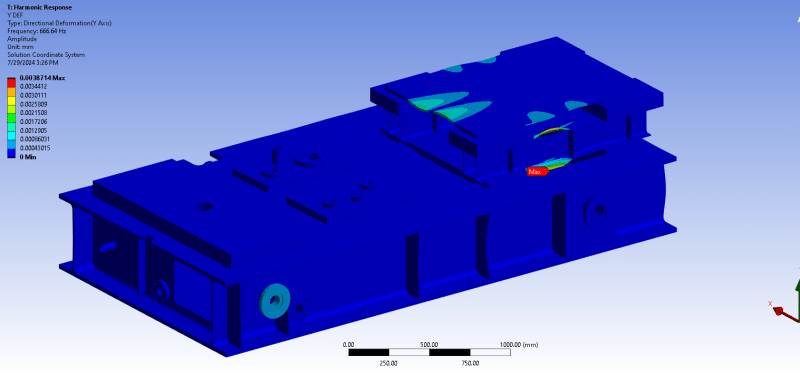

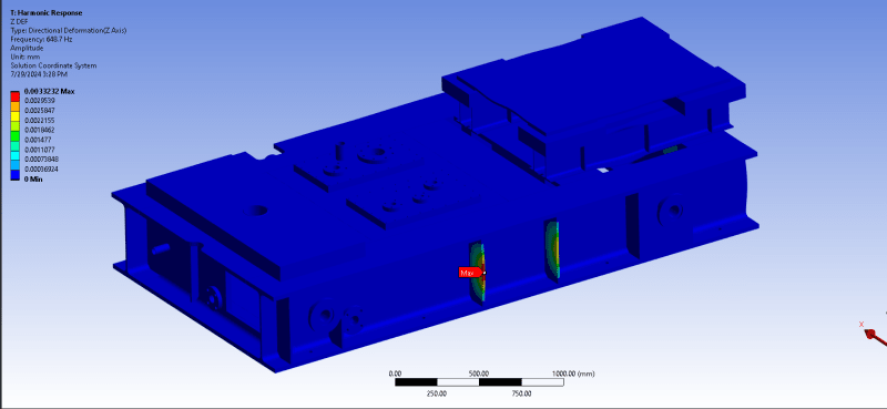

no i didn't do real modal analysis, just in Ansys workbench. yeah i have seen mode shapes and they are not in critical area like motor base plate or compressor base. they are mostly in stiffeners or beams webs. i also perform a harmonic response analysis and deformations amplitude are way under ISO 10816 limits but velocity is not. my question is what kind of vibration can i ignore? how should i judge?( i attach deformation and velocity response in near working range frequencies)
My maximum velocity value is 33 mm/s but in ISO 10816-3 maximum allowable(zero to peak) is 5 mm/s.(*note: the location of applying harmonic load is on gearbox base plate)
Well, you are working to a standard, you have done the test, and it fails. So, either the standard gives you a let-out clause, or your test is wrong, or your structure needs redesigning. Unvalidated FEA is just pretty pictures on a screen.
