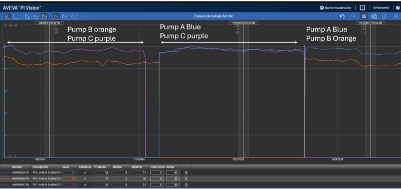

It is still unclear why when pump B runs alone the vibration dissapears, but when runs in parallel with either A or C vibration appears and absorbed current of motor B gets lower in comparison when runs alone.
I am still waiting to get more data from Operations team. Has anyone had experience of suction piping layout casuing more flow going to one pump (say A in my case) and less flow goping to other one (pump B) when running in parallel?
 https://files.engineering.com/getfile.aspx?folder=2a7db7d7-4240-4345-9989-ad4a237378bb&file=Pages_from_P&ID_Master_17_May_2022.pdf
Performance curve and trend for current. When pump B runs in parallel with other pump absorbs 41-42Amp, while other two pumps are stable at 48Amp

But pump B is operating at 15% less power which equates to about 200m3.
Can you get flow data for each pump in operation? Or do a test on pump b alone to check the pump curve?
