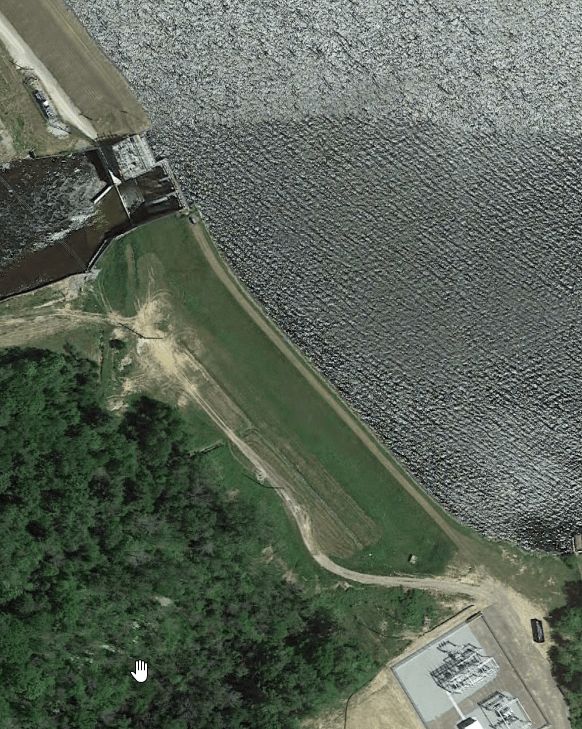

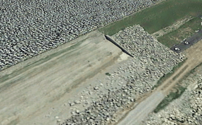

Well I didn't mean it was concrete but you seem to be correct. The plug idea looks like it was designed to go once over topping occurred and result in washout of maybe a metre or so of earth on top of the concrete spill way.
This is a rendered gE impage but seems to show the detail you describe.

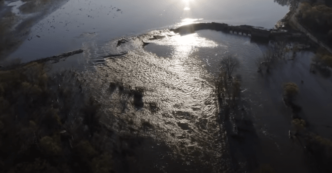

I suspect the remains of the concrete spillway is the disturbed water area you see on the drone footage.
However if the water level is so high and the flow so massive that you over top the entire earthen bank on its far side then the fuse plug is irrelevant as there is now nothing to stop virtually the entire lake from draining.
It's only because the downstream river has backed up so much that the lake isn't already empty now.
Yes, you are correct. I was being overly semantic, my apologies. The whole reason this dam, the Sanford dam, had its license revoked was because it would overtop during the PMF, about a 1/10000 annual chance of exceedance storm. While this storm was not that event, the upstream failure released more water. This dam did fail from overtopping with inadequate spillway capacity, fuseplug or not. Interestingly, we can see the two most common failure modes between these two dams.
Also going through aerial imagery, the concrete spillway wasn't even original, and was added after a FERC order in 1999. Who knows what the damage would have been without the spillway.

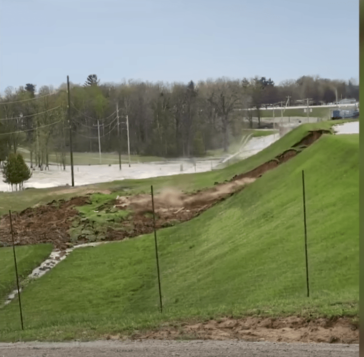

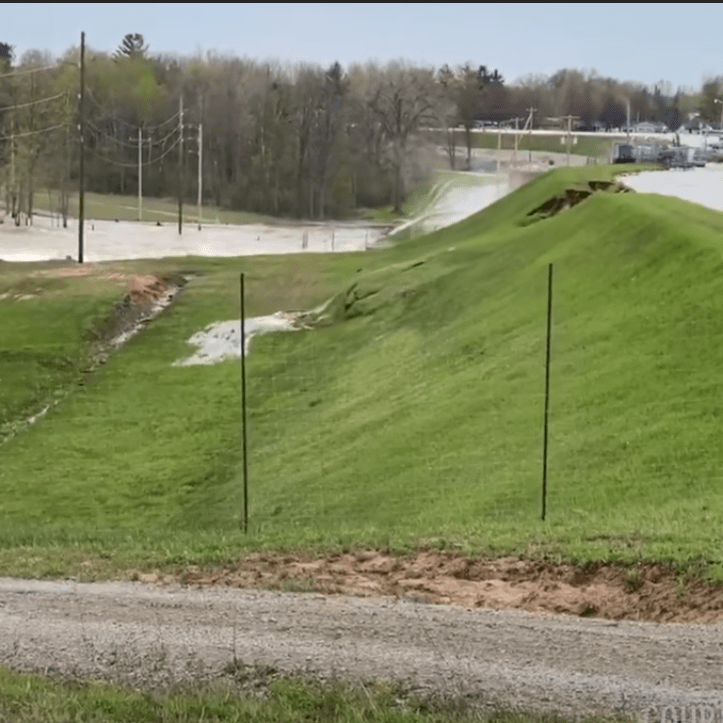

Sorry for the multiple messages, but I'm still thinking this through. It is possible this was purely a slope failure due to the increased seepage and rain saturation. In that case, the slope was not stable during an unusual event and should have been rehabilitated. As I said before, this portion did not have the toe drain. Looking at the other portions that did have this toe drain, an additional berm was constructed at the toe. This berm could have helped with slope stability, but again this is all purely speculation.
Don't apologize. You seem to be one of the more knowledgeable on dams here. I'm pretty rusty.

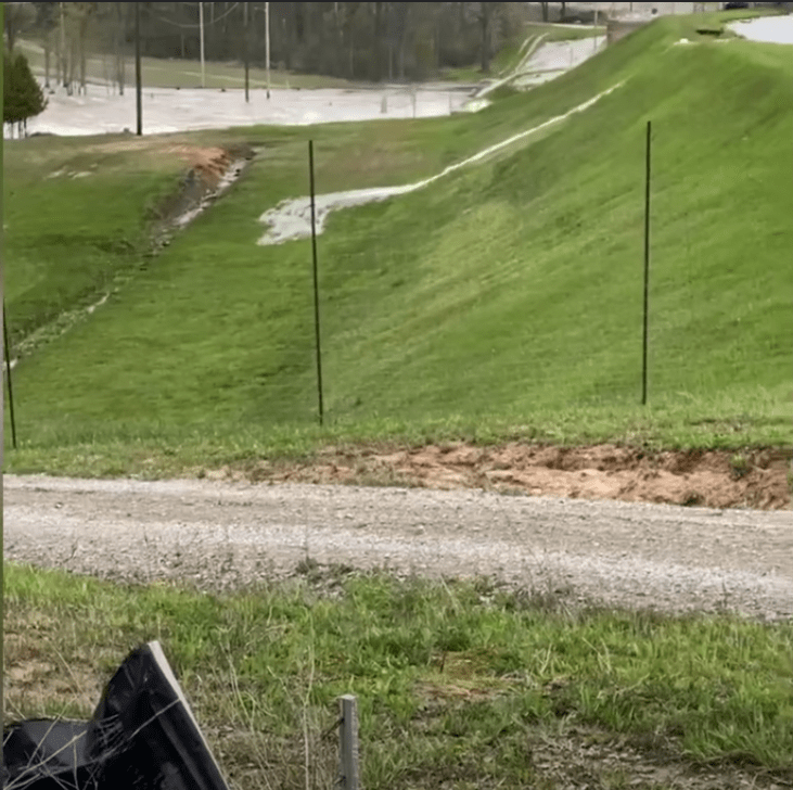

The original video was slightly longer. I've seen it elsewhere but I can't find it again. The original video showed significant water seeping through especially towards the top though it did not seem like it was overtopping. From my limited knowledge, it seems like a slope failure from a saturated dam wall.
I saw a few photos of the broken dam and it looked like a clay plug but not all the way to the top. So the earth mound gets saturated with a high level and then slides down fatally weakening the dam wall which breaks through moments later.
I had a closer look at the video posted by Human909
The google earth shows there is a road or path at the crest which is 6m or 20 feet at least.
The video image shows water up to the downstream berm, roadway is flooded and that is not 6 m or 20 ft of crest.
Water is overflowing
Sinkhole on crest
Shallow circular failure occurs
Water eroding circular failure
I am not familiar with fuse plug spillways but if the goal was to have the spillway erode down to below the elevation of the working spillway then it worked. If it was only supposed to erode a minimal height but maintain the reservoir to the working spillway elevation than it did not work. The fact that a circular failure occurred instead of a erosion rill which expands shows the downstream slope is over steepened. When the water subsides it will become evident as to how much of the spillway remains and if a channel formed lower than the intended spillway crest.

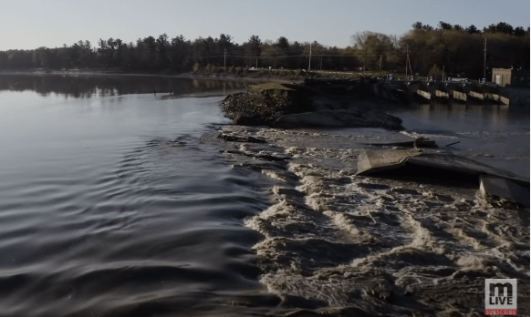

This is edenville on 22nd May
Basically the dam has ceased to exist and water level would be lower if the downstream system could accept more water.
