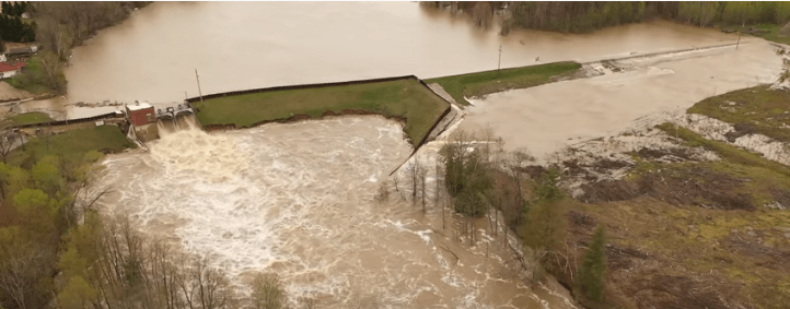

The real crime here was in apparently not having a reliable emergency spillway suitably protected to avoid washing the rest of the dam away.
That bit should have been relatively cheap to do.

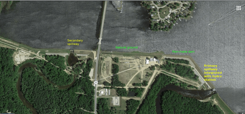

The Edenville had an emergency spillway comparable in size to the one integrated with the hydro. This is evident in the footage I posted on 24 Jun 20 19:22 which is possibly one of the most important piece of evidence.
The modification work could be quite substantial if the dam was still impounding Lake Wixom. Also when the dam failed it is evident the dam was just an earth filled dam without any erosion protection. The modification is likely to require extra dam height, extra widths, extensive erosion protection, rehabitation of the existing spillways and reinforcing the downstream areas with concrete apron and energy dissipators. It wouldn't be just adding 100% more spillway but bringing a 96 years design to the current standard.
Also the two existing spillways have taken up a good portion of the dam section so the addtional capacity has to be fitted in with the existing infrastructure which comprises of partially man-make dams plus natural earth mounts.

I watched the video listed but I would term the spillway as just that - a controlled spillway.
What I mean is a purposeful slightly lower area of the main dam which is suitably protected but allows spillage over a large length to protect the rest of the dam.
Contrast that dam with the smallwood dam where although it "overflowed" and consequently did flood the downstream, but no where near as much as if the whole dam had gone.
You can see the sheet piling work around the earth core dam and the emergency spillway working as it should to reduce water level to prevent uncontrolled overtopping and complete dam failure.

I would agree that there were two spillways, called Tabacco River and Tittabawassee River spillways according to the Spicer Report. The emergency sections of them for overflow, if existed, were not clear.
It is interesting to note the court papers served on Boyce the dam owner was about a drawdown of 8'.
The Spcier report describes the sill level of the spillways being 667.8ft and the normal lake level of 675.8ft. Thus the difference is exactly 8'. It is possible that Boyce wanted to leave the lake at a level so that all excess water would be discharged via the spillway, as that mean no attendent would be necessary for a defunct hydro plant.
The Spicer report also described the Federal estimates of Probable Maximum Flood (PMF) being between 74,360cfs (original), 61,936cfs(2011) and 67,800cfs(2013) for the Titabawassee/Tobacco rivers. Michgan State's own standard is apparently to mandate the dam to pass 1/2 PMF.
The combined net width of the two spillways was 129ft. Since the top of the dam is 682ft so the discharge capacity of the two spillways when the water level breached the top of dam is about 21,000 cfs which does not meet either the state or Federal requirement, according to the Spicer report.
Historical peak flow rates according to this site ranged between 39,000 to 28,000cfs between 2017 to 1943. On the day of dam failure one report claimed a maximum flow of 60,000 cfs while another quoting a station further downstream at Sanford dam recorded 85,000 cfs
If the flow rate was anywhere near 60,000cfs then the dam was doomed even it has been modified to pass 1/2 PMF to satisfy the State's requirement.
