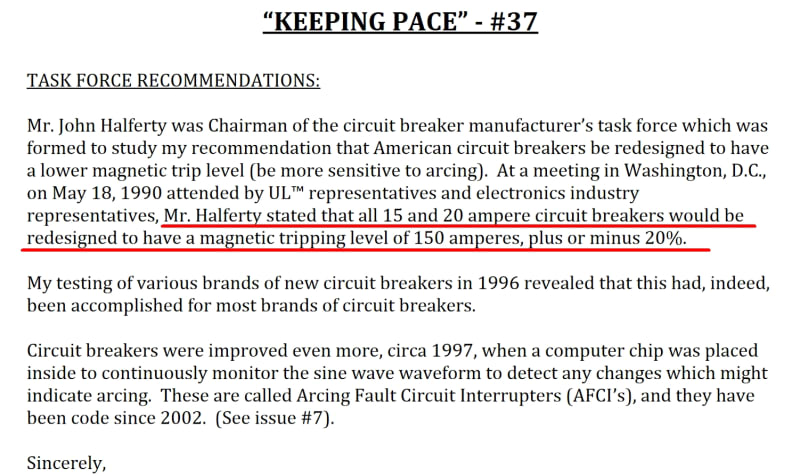

@Waross: Please see these attached documents on why the magnetic pickup was lowered on 15 and 20 amp single pole breakers:
And of course, what started it all:
There was a major industry effort to lower the magnetic trip threshold on all 15 and 20 amp breakers when it was theorized that thermal tripping resulted in fires.
And of course, we have this video:
Current 125% over the instantaneous trip function is what provides arc fault protection as validated by several major UL studies spanning two decades.
However- it was soon realized that because the NEC, specifically 250.4 A 5 doesn't define effective ground fault current path and nothing limits the run length of final circuits (unlike most foreign codes and IEC 60364) it was theoretically possible to have short circuit levels below 150 amperes at the furthest point of some residential circuit.
75 amps was settled upon being the lowest short circuit value that may be found in a dwelling based upon the longest reasonable run for a circuit (large home, panel in the basement).
Thus the original AFCI was drawn up as being nothing more than coil with a pickup of 75 amps. However it was soon realized 75 amps would nuisance trip on motors starting, light bulbs burning out, ect.
For this reason the electronic AFCI was created that ironically would distinguish between a vacuum cleaner starting and an arcing short circuit.
What makes me, electricians and so many others irate to no end is that instead of NFPA-70 adding a table restricting final circuit lengths for a given wire size and breaker rating they mandated an expensive failure prone device that is really nothing more than an empty fire extinguisher. If it can't tell between dangerous arcing and a switch mode power supply, who says it will actually trip on dangerous arcing? How says the electronics will still be functioning in 40 years, especially when UL claims multi kv power surges are causing insulation break down and high current arcing in from over driven staples?

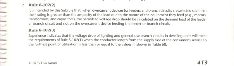

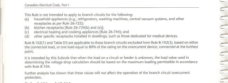

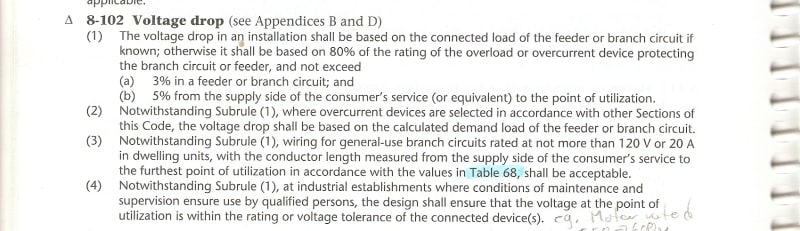

Canadian Electrical Code said:
8-102 Voltage drop (see Appendices B and D)
After reading your post concerning the legal action that the CSA (Authors of the CEC) have instituted in regards to Copyright infringement, I leave it to you to locate a copy of the CEC.
Suffice to say that rule 8-102, Appendix B and Appendix D explain the derivation, purpose and use of Table 68.
The number of codes and reference books piled on your desk is immaterial if the stack does not include a copy of the CEC, when you chose to post false information as to the purpose and use of a table.
Bill
