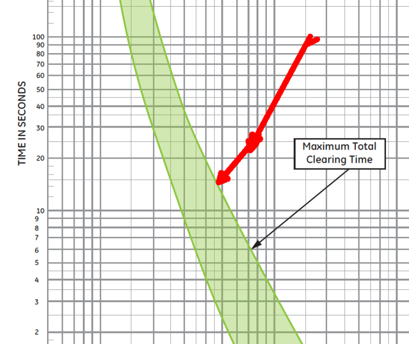

Here is a typical field calc for branch circuits:

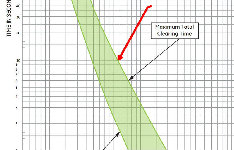

An example of where high ground fault loop impedance may result in hazard to life and property based on Preece fusing current-

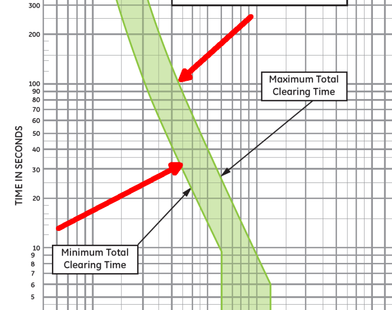

As applied to breaker time current curves:
10 gauge EGC 333 amps / 60 = 5.55
8 gauge wire 472 amps divided by 100 = 4.72
6 gauge wire 668 amps divided by 200 = 3.34
A 60 amp circuits will result in the EGC melting under acceptable worse case breaker clearing times, a 100 amp circuit has a 50% chance of the EGC melting before the breaker opens and a 200 amp circuit has a 100% chance of the EGC melting (breaking the the path back to the source) before the breaker ever opens.
Based upon these time current curves of a common brand name UL listed breaker one could make the inference that Table 250.122 assumes a clearing time faster than 10 seconds (and as such the intent {goal} of the code) is that a ground fault clear in less than 10 seconds.
Complementing the above, a lab example of delayed clearing with a 60 amp OCPD on 6mm2 (5.26mm2 = 10AWG) wire.
Smoking starts about 15 seconds after energization, breaker trips at about 40 seconds.
For a real world 60 amp circuit trip should not exceed 5 seconds. Going by a typical time current curve 480 amps is indicated for a 5 second trip giving a max Zs of 0.25 ohms at 120 volts and 0.577 ohms at 277 volts.

Here are the two equation that I am (mostly) basing my inferences on:
Some slight changes being that I am assuming 115 volts (lower end of the acceptable bandwidth) and that the fault current must be 125% over the breaker's minimum magnetic pickup as derived from the attached time current curves. Also I am not concerned with the "home run" instead the whole circuit to its furthest point but ending at cord caps and light fixture leads. 30*C vs 25*C in UL's research.
GFL = ground fault loop
15 amp breaker:
14-14 = 124.672 feet = 0.6361513472 ohms GFL =/= 188 amps at 120 volts, 179 amps at 114 volts
12-14 = 196.85 feet = 0.826238505 ohms GFL =/= 145 amps at 120 volts, 138 amps at 114 volts
10-12 = 314.961 feet = 0.8294812896 ohms GFL =/= 145 amps at 120 volts, 137 amps at 114 volts
20 amp breaker:
12-14 = 164.042 feet = 0.6885334866 ohms GFL =/= 174 amps at 120 volts, 166 amps at 114 volts
10-12 = 229.659 feet = 0.6048299424 ohms GFL =/= 198 amps at 120 volts, 188 amps at 114 volts
Assuming 2000 amps of fault current Line to Neutral at the panel board we obtain a Ze of about 0.05 ohms...
So adding 0.05 ohms to 0.8294812896 = 131 amps at 115 volts
Adding 0.05 ohms to 0.6885334866 = 156 amps at 115 volts
This is right up to 131 and 150 amps-
15 x 7 = 105 amps ==== 125% of 105= 131 amps (UL's parellel arc mitigating threshold)
20 x 6 = 120 amps ==== 125% of 120 = 150 amps (UL's parallel arc mitigating threshold)
