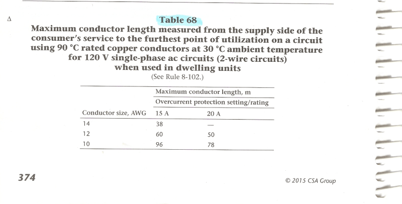

@Waross: Going by a 30*C conductor impedance Table 68 guarantees the breaker will trip magnetically (in 1.5 cycles) thus providing parallel arc fault protection.
Here are the calcs but done at 75*C:
So the question then comes up, why does rule 26-724(f) mandate AFCIs when table 68 already provides total parallel arc fault protection coverage?

It is pretty obvious that you do not have a copy of the code that includes Table 68.
Table 68 has nothing to do with fault currents or ground loops.
And as sad as the situation with the CSA may be, what on earth does that controversy have to do with the coefficient of resistance between 30 degrees and 75 degrees?

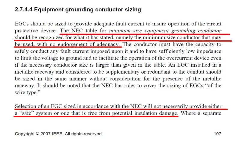

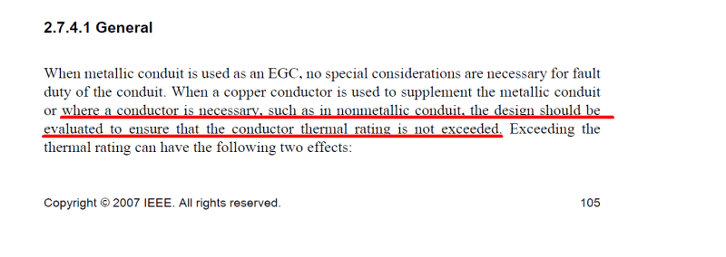

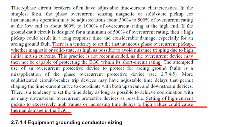

And I know critics will raise doubts as to the legitimacy or accuracy of this remark: "fusing of the EGC" "EGC will not fuse" and "adiabatic limits"
To that I will simply cite the IEEE Green Book which makes numerous references as to Table 250.122 being inadequate when a breaker does not trip magnetically or under exceptionally high fault currents:

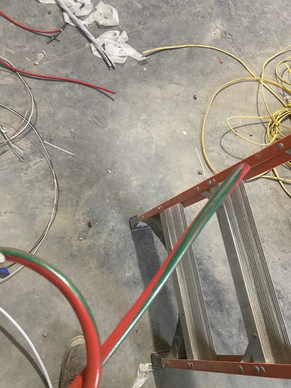

Real world pic...
It is for this reason every engineer must compare relative fault current with disconnection times against conductor adiabatic limits.
If this is not done, technically the the EGC must be the same size as the phase conductors for circuits up to 6 AWG, and half size in relation to the mm2 value for circuits over 6 AWG (if not 4AWG).
Ie, a 350 amp circuit without adiabatic consideration, known fault current or disconnection time, would need a 500MCM (253mm2) phase and a 250 MCM (127mm2) equipment grounding conductor.

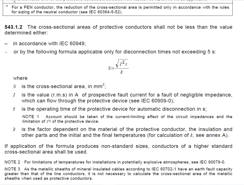

My reference from IEC 60364-5-54:
I am very much aware that 99.99% of the time wire EGCs are based on Table 250.122 of the NEC or Table 16 of the CEC without question.
However, if one looks at 90.1 C referencing IEC-60364 or the IEEE it becomes rather apparent that the minimum EGC wire size as listed in NFPA-70 or the CEC may be inadequate under certain conditions.
So I can understand why people would raise eye brows where I have drawing showing what at first notion appears to be grossly oversized equipment grounding conductors- however to that I will say just because it may be technically legal (key word may) does not mean its right, safe or ethical. Or that I am unaware of how to correctly apply the code.

If you read the code you would know that Table 68 has to do with maximum allowable voltage drop on residential lighting circuits.
The voltage drop percentages are stated in the code, but table 68 lists maximum circuit lengths despite calculations and only for evenly distributed loading.
