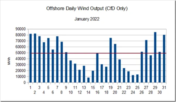

This is the daily energy production from about half of the UK's OFFSHORE wind turbines, in January (ie winter when solar is useless and wind is are supposed to be strong)
[URL unfurl="true"]https://res.cloudinary.com/engineering-com/image/upload/v1647583367/tips/image_thumb-65_nvhbzx.webp[/url]
So if we needed it for baseload, to maintain the average power out put we'd need to install 297 GWh of battery, about 6 days of average production.
As such minute to minute variability is not really important, you need to be looking at the day by day totals.
Now, if we overbuild the turbines, ie plan for less than 50 GWh/day , we can reduce the batteries required, while obviously spending more on building windmills for a given baseload. That's an interesting CBA, studiously avoided by the people making money out of this stuff.

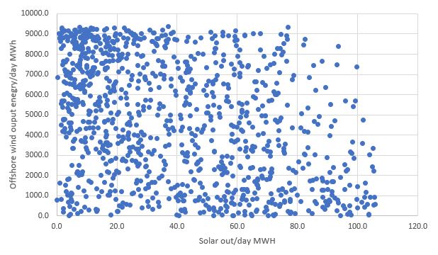

for several years of data including solar.
The other thing to look at is testing the claim that 'the wind is always blowing somewhere' and 'solar works when wind doesn't' -which is already dead in the water.

That's just for one PV farm and one offshore wind station. Yes, there is a tendency for the wind to blow on gloomy days, and calm days tend to be sunnier, but there are plenty of exceptions.
Cheers
Greg Locock
So the maximum PV solar out is about 2% of the wind station.
Is there any way to normalize the outputs to facility price or "size" ?
Greg - each data point in your scatter plot is a given day (i.e. that day's wind and solar output)? So there are a lot of points in the lower left quadrant where the combined output of the two is low...
