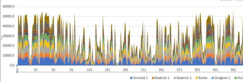

Further thought is that although this is the best data I have, it is misleading to assume that the company producing it has any intent of building a good baseload fossil fuel free generating source. That is, offshore windpower is sited where it will maximise foreseeable income (etc) so they all tend to be clustered in the same areas, where inevitably their output will be somewhat correlated.
This is the offshore wind for all the offshore windfarms I chose in 2020 ( ones for which i have a complete record 2020 and 2021),as you can see, they are heavily correlated. I don't see any point in doing R^2 on this sort of stuff, it's pretty obvious that when its windy its windy everywhere, and when it isn't it isn't.
However, with a little bit more data manipulation I can now build a toy that has 4 knobs, offshore wind, onshore wind, PV, and battery size. Add in costs for each one and we can see what the cheapest way is to put a portfolio of PV ONW and OFW, and batteries together to provide 364/24 @ 1 GW power. I've changed the criteria a bit because maintenance on all those generators is done continually on individual units rather than an annual shutdown of the whole site. Then I can test the 2020 settings on 2021 and see if it is robust.

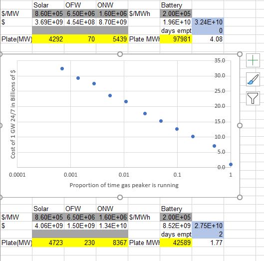

So one vital ingredient is the cost of each power source, and the battery
These are my estimates for installed costs, first 3 from wiki, last is Tesla battery*2
Code:
	Solar	OFW	ONW		Battery
$/MW	8.60E+05	6.50E+06	1.60E+06	$/MWh	2.00E+05
I think that underestimates the social cost of onshore wind, but anyway.
To get to full net zero (0.5 days per 2 years downtime on the graph due to logs) the optimum mix is in the yellow boxes, note how little offshore wind is needed. It needs 4.08 days of battery storage, and would cost $33B. And to answer my original challenge as revised, 1 day per year of downtime would cost $27B and needs a 1.77 day battery, 43 GWh.
A less daft solution would be to get emissions down to 10% of the original, for $13B

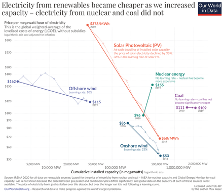

I was just thinking about the abandonment of the USA's nuclear building program. (that and the non existence of Australia's). If we really are serious about zero CO2 then we need nukes. One thing often cited is that they are very expensive energy, eg this piece of propaganda, the LCOE.
I'm sure the numbers are justifiable in context, but as demonstrated further up the page, only if you ignore the cost of storage. In a system designed to operate 24/7 storage costs are a huge proportion (43%) of the cost equation in a wind and solar energy grid. So wind and solar should double in that graph. With the cost base I used, a 24/7/365 power supply using wind/solar/batteries is about $28 billon per GW, anything cheaper than that is, um, cheaper. I'm pretty sure that quotes of $56 billion for a 2GW nuclear plant would be greeted with laughter, yet that is what we are buying in to.
