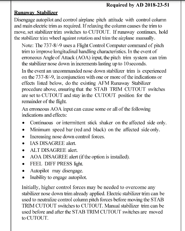

The issue is that when you read the AD it continually emphasises set the trim switches to cut out. Only right at the end it say you "can" use the trim switches to stabilise the airplane, not that you MUST or even SHOULD. But it say set the trim switches to CUT OUT seven times , all of them in CAPITALS.
Also doesn't mention Auto throttle at all.
If this was ever going to be a "memory" item that's what would stick in my mind. Hence why lots of people said the pilots did (at least initially) exactly what they were asked to do by the AD and the plane still crashed. Also the "trim the aircraft manually" turned out to be physically impossible because they had reduced the size of the trim wheel, plus doing it at higher speeds needed more force than they could physically apply. Hence the AD was asking them to do something which couldn't be done in many circumstances. Not to mention that it would take something like 100+ turns to get it back toneutral trim.

What is the first sentence of the AD?
Use Main Electric Trim as required.
"Auto throttle" is part of the stall warning procedure, which happened before they reconfigured to enable MCAS.

Also "What is the first sentence of the AD?
Use Main Electric Trim as required."
Err no, the complete sentence says "Disengage autopilot and control airplane pitch attitude with control column and main electric trim as required."
So the clear main instruction is to control the pitch using the control column. The "as required" bit makes this an optional thing to do the way I read it.
The big thing they don't tell the pilot is that if this is a MCAS runaway, the control column won't cut out the trim command in the same way as runaway trim does. To me its a very confusing directive, but the clear instruction is set the trim switches to CutOut. The fact you're then trying to control an aircraft with loads of force on the column isn't really considered.
For me they missed a big change not emphasising that the thing to do was use the electric trim FIRST, then set cutout switches within 5 seconds of getting nearly level flight.
