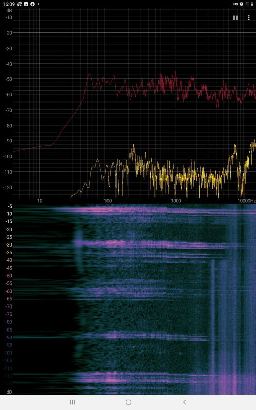

Download Spectroid. It will find your leak, big or small. If aviation tech doesn't know about ultrasonic leak finding or soap bubble tech I'm sticking to trains. It's a 2h flight to the mainland, or a 3day boat ride, so I probably won't be leaving very often,
The pulses at 8000 Hz is me bearly hissing heard over the lower freq noise of a passing car 30m away.
Interesting app - thanks!
Welcome. In a quiet night env, it hears everything. What the neighbors are up to, or ocean waves 1.5 km away. I like seeing the Droppler effect of the cars and helicopters going by. Bees come in at 275Hz, house flies at 400+.

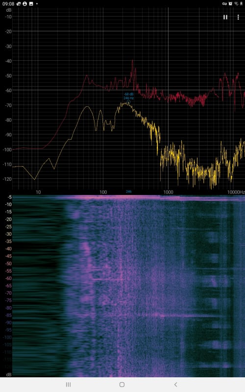

Yeah Dik. Turn the gas stove or fireplace on so low you can't hear it. Check the sensitivity.
I bearly cracked the needle valve of bottle of butane under my torch nozzle, bottom right 3 bars and slowly closed it until I couldn't hear it at all after the lines got lighter, yet it still registered until I turned it the last 5° or so and it cut off entirely.

Checked it with a light breath... even the faintest one registers 'bigly'. Have to experiment to see if it can record heartbeat and pulse, or maybe be used to a stethascope (sp?).
I revised the foto above for a faint gas flow from a torch. I could not hear it at all at cutoff.
