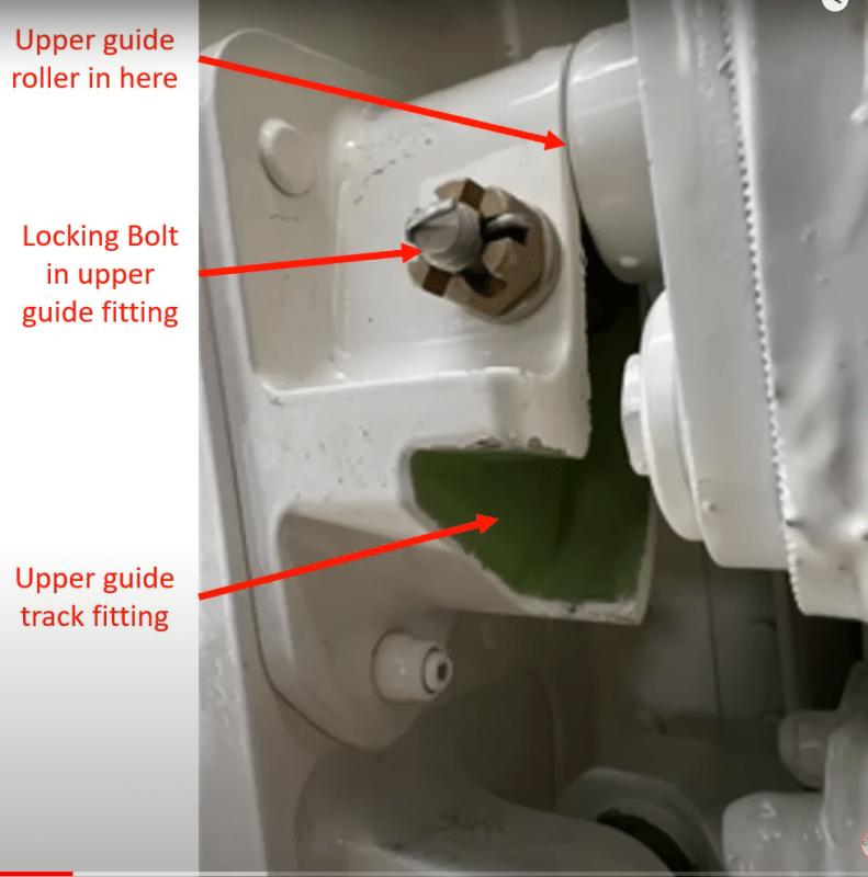

Seems remarkable that the plug was only restrained in movement by 4 bolts that are difficult to check without removing the internal covers.
I presume those bolts were meant to be subject to lockwire and a dupe sign off after installation.
In one of the 737 tech videos above, I think they were shown as having a castellated nut with cotter pin.
Seems to be a culture difference be it lock wire or cotter pin to do the same job.
BAe aircraft have miles of lockwire on nuts and the technicians perform art work with it.
Bit like the Rudder nuts that have been coming off they are meant to follow a duplicate inspection and sign off process. Be it cotter pin or wirelock.
Quite what the pro's and cons are between the two methods I really don't know. Although personal experience with lockwire involved a hellish amount of blood leakage getting up the experience curve on the very basic stuff never mind the "art work" they do on fuel injectors and the like.

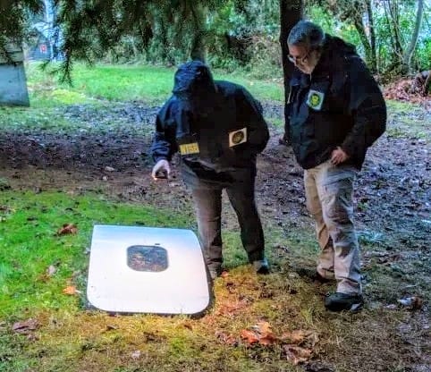

"Alaska Airlines placed restrictions on the Boeing plane involved in a dramatic mid-air blowout after pressurisation warnings in the days before Friday's incident, investigators say.
The jet had been prevented from making long-haul flights over water, said Jennifer Homendy of the US National Transportation Safety Board (NTSB).
The NTSB also says the missing section of plane has now been found - in the back garden of a Portland teacher."

Taken as snap shot form the excellent second video listed by 3D Dave. This is the top set of guides and pins. Lower ones go through the vertical spring guide and sleeve. Door is on the left so this is the upper right fixing.
Door very clearly goes up initially to move the main pins away and then looks to have a hinge assembly which allows the door to hinge down.
A number of comments on the video say that the door is commonly removed during interior fit out to allow for access for tools and equipment.
So, no latch on the plug? (Too heavy?)
Just the interference bolts?

Well it must odds on that there simply no bolts installed on that particular air plane.
Even one bolt there would stop the door movement but seems inconceivable that a 3 month old plane could fail in another way.
Only way I can see is if the top bolts were there but the bottom ones not. Then there is a force trying to lift the door up, but hitting the top bolts which finally gave way?
I doubt that the springs are strong enough to shear the top bolts if the bottom bolts are missing. They should only be strong enough to counter the weight of the plug (or possibly the heavier door), otherwise it would make closing the plug much more difficult than it needs to be.

Murphy, what I meant was that the spring allows for some movement up and down as the plane pressurised, or not as the case seems to have been, but still enough to put a lot of force on the bolts.
But the main thing seems to be no bolts as far as an obvious error seems to be.
What seems to be the rather undamaged looking door.
