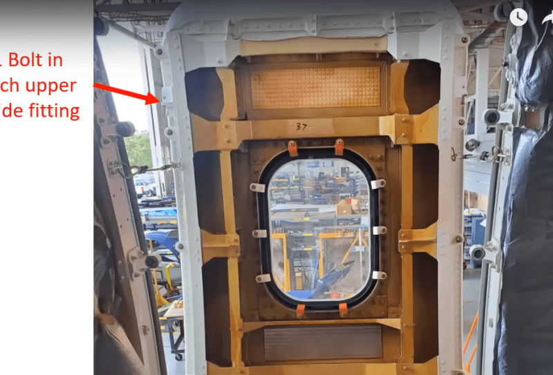

Seems like wishful hoping for all 12 stop pad/fittings to share the load anywhere near equally.
What actually holds the pressure in?
If you look at the construction of the door the horizontal stiffeners are quite robust while the vertical stiffeners are slender. This means the door will be somewhat flexible about a horizontal axis which will help it share the load amongst the stop fittings vs a more rigid door.
The structure has to take negative pressure 0.5 PSI I think it is before the safety valve triggers to prevent implosion.
I presume the stop pads are to distribute the load to the rest of the hull structure. Any less and you would have to beef up the ribs and stringers. And have cylindrical buckling issues.

There is some sort of fastener in the stop fittings.
Perhaps to hold on a wear pad and shims?

Seems on the door there is evidence of fractured guide fittings.
Looking at the relative size of the guide fittings and stop fittings, I think the guide fittings will remain engaged after the plug has moved upwards off the stop fittings, transferring the full pressure load onto the guide fittings and hinges. That makes the fracture unsurprising to me, and a consequence rather than a cause of the problem.

Those connections look pretty flimsy. Is that sort
of thing common in aerospace?
Such connections are not uncommon in aircraft structures. The plug in question not an especially novel design. It utilises the same means of attachment as the functional emergency exit door it replaces. That exit door configuration existed on 737s prior to MAX.
Having just watched today's NTSB media brief, this was actually stated in it by one of the lead investigators, at 29:12 in the livestream.
NTSB Media Brief - Alaska Airlines Flight 1282 (Jan 8) livestream @ 29:12
