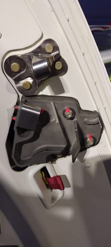

Just a pic how the Canadians do it
It certainly does appear that at least some of the bolts were missing. However, they're still looking for one of the lower hinge pieces that is bolted to the plug and the spring that pushes it up. In the pictures posted above, the other one is visible still on the airframe and not attached to the plug. So, the failure likely is not as simple as the bolts being missing and the plug popping out of the airframe. The fix won't be as simple as checking that the 4 bolts are installed either.
In the end though, it squarely points to Boeing having serious QC problems.
No, it appears quite simple that the 4 restraining bolts were missing and this allowed the door to open. There is no other plausible cause at this time (though we might yet be surprised). Once the door opened, it swung down on the hinges, as it is designed to do. But it is now in the airstream, so it likely tore off part of one or both hinges as it departed the aircraft.
Yes, a significant quality escape somewhere. As is the number of other loose bolts found in the door structure. See:
It's already been PROVEN by inspection that OTHER bolts in the door assemblies have been found loose...
yes, but those loose bolts do not appear to have anything to do with the plug door opening.
None of the other loose bolts could in any way allow the door to leave. If the bracket retaining bolts had been removed the spring that is to push the door out of position could no longer to that; it would eliminate a way to get the door to leave. Sort of an anti-defect for this accident. As long as the upper keeper bolts were in place the door could not move off the stops.
