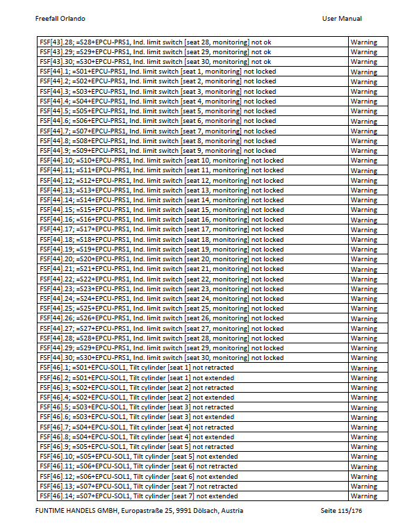

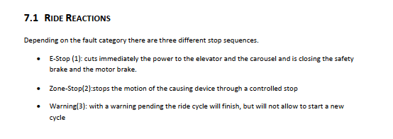

I tend to think it was a false latched indication. I wonder if he had shoved the restraint open on the way up if the ride would have aborted?
Page 115 of the operating manual seems to indicate that a seat that becomes unlocked will trigger a Warning--not an abort. I believe "Z-Stop" would effectively be an "abort" but returning the ride to the unloading position would be performed manually by the operators (in the manual, they detail this as "evacuation mode" in another section).
...and the 16 year old kid in charge obviously read the manual. [ponder]
Is it possible the rider was holding the restrant bar down but it wasn't able to latch but was able to close the limit switch? (Badly positioned proximity switch or proximity switch with a washer taped to it) In my experience PLCs aren't much for logging unless there is a software package or an HMI connected to it, considering the level of complexity (seperate safty PLC) an HMI seem very likely. Hard to imagine you could start a ride cycle with a unlatch signal active.
