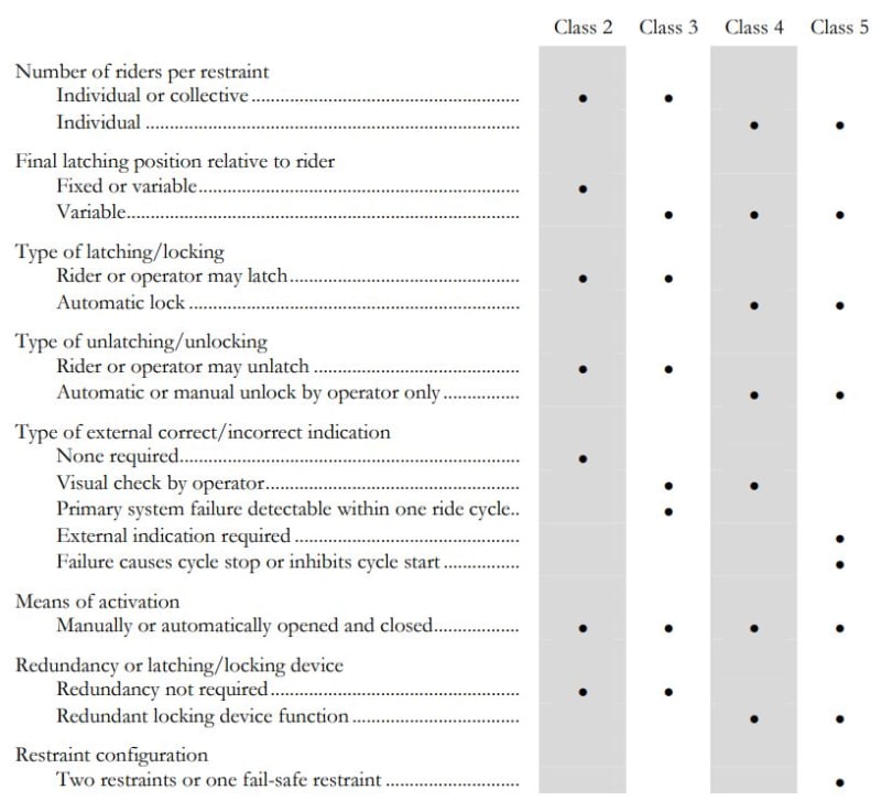

Anybody know what category 5 system means, I'm familiar with SIL(safety intergaty level) levels but they only go to 4.
May mean class 5 restraint system Link

Cat 5 to what standard? As stated it is meaningless. You could say Cat 1000,
What "requirements"???
What TUV standards???
The letter says nothing.
Wow - the project report in the link is very detailed. It does mention there are no mandatory federal standards, only voluntary use of ASTM standards.
Although the catagory does not seem to be properly referenced, it does appear to conform to Class 5 in the document shown. In particular the last 3 items, and possibly 4 items. It's also nice to see the applicable ASTM docs referenced, just to know what ones might be required:

Cat 5 also calls for
"Redundant locking device function"
And
"Two restraints or one failsafe function"
Difficult to see those at the moment.
Class 5 allows for a varible latching position, it seems to me all the redundancy is meaningless if the latch position is not close enough to the rider, but I guess that's where the operators come in.
