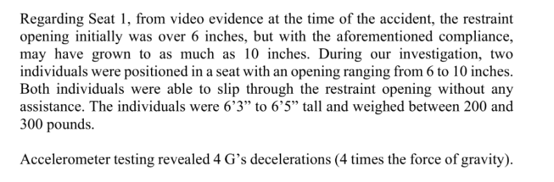

Smoking gun: Someone adjusted the position of the proximity sensor for two of the seats (including the one the victim was in) to allow for a larger opening--almost 7 inches vs 3. They also found evidence it was readjusted after the original installation, by way of bolt marks on the bracket. Now... Who did this?
To be honest, even that "normal" gap looks rather scary to me but the extended one is unreal.
How no one fell out before now is actually puzzling but may be they forced it down beyond the max opening.

One thing they mentioned in the report is that they tested the seat with someone of similar size to the victim and the foam of the seat compressed an additional amount. They said their testing showed the gap could have been as high as 10 inches...
Also up above there was some speculation about the forces involved. In the report they say testing with an accelerometer showed that the ride pulled 4G's...
