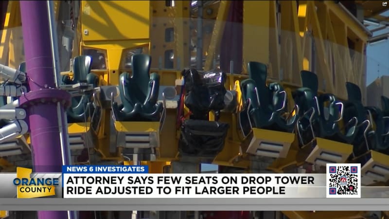

According to this story Tyre was 380 lbs. And the ride entry queue does not have a weighing device for riders.
[URL unfurl="true"]https://www.clickorlando.com/news/local/2022/04/05...[/url]
You missed the lede ...
Some seats were adjusted for larger body types and the victim was directed to sit in one of those seats.
You wonder what sort of adjustments they made?
The safety check before the ride starts is the weak point in this being a repetitive task undertaken by young ride operators.
There may be some checks on the harness lock, but if the secondary seat belt click is both an easy visual and practical check, but give you that crucial level of redundancy. I just can't really see why this is somehow seen as any sort of onerous additional action.
The length of these is fixed and hence requires the harness to be pulled down to some sort of minimum level leaving not enough space for someone to escape under the harness.
The fact in that photo that the seat has been removed may also be crucial as the lower between the legs bump is a critical part of the restraint.
Was trying to think of a way to prevent overload without resulting in court cases about embarrassment.
Only thing I could come up with is an interlock that blocks the restraint coming down if its over the weight limit.
Which then removes the human from the decision making.
And adding to the cost, as every seat would need a weight sensor.
Cheaper than killing someone or being sued for a young kid saying get off fatty.

In the photo above, they removed critical parts of the restraint system with no apparent replacements
> seat bottom with leg constraints
> side rails
TTFN (ta ta for now)
I have seen chest size limits posted on some rides in the the UK which at least is an easier thing to measure and not related to the weight or perceived obesity of the individual.
IR stuff - other pictures show the seat and side restraints were there on the night - I suspect they have removed these for testing, hence my question / point that the harness may have done it's job, but the seat is an integral part of the restraint with the side elements and the upstand between the legs.
