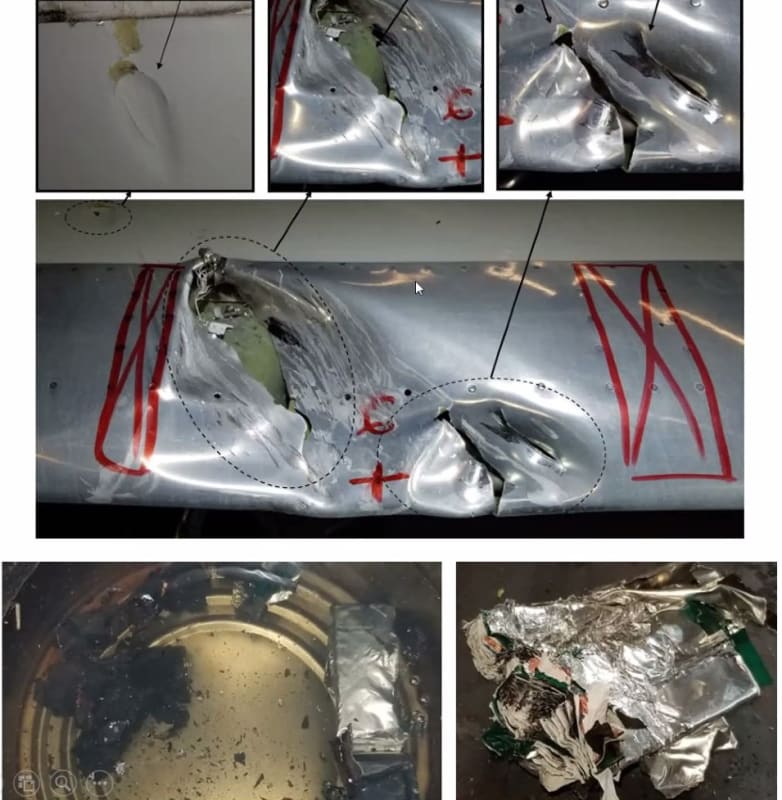

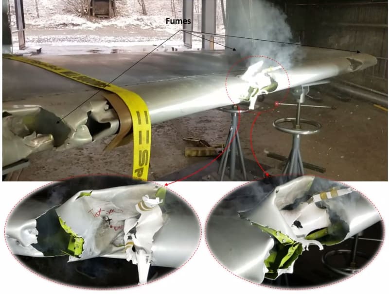

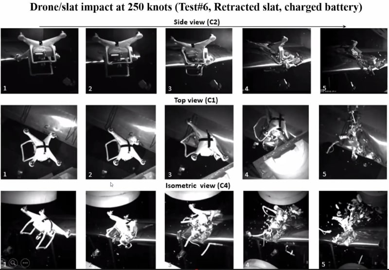

You may also be interested in this recent webcast from CASI.
AIR-TO-AIR COLLISIONS: DRONE IMPACT DAMAGE ASSESSMENT ON AIRCRAFT STRUCTURE
These are drone collision tests using an actual drone and actual aircraft structure. This is jet aircraft structure so the speeds are higher. Collision speeds at 140 knots and 240 knots were simulated (typical of takeoff, approach speeds). The damage was substantial in many cases. Windshield impacts were terrible - fragmentation that would severely injure/incapacitate the flight crew. Damage to control surfaces (slats) rendered them non-functional. Components of the drone or the entire drone remained embedded in the structure in several cases. A case of primary structural damage occurred (not just skin damage). A case of lithium battery combustion was observed.
Some highlights:
