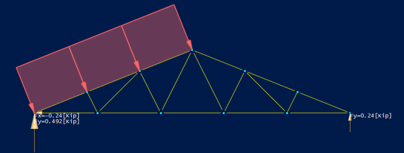

Truss reactions provided are as shown. What is the RL? I am thinking lateral, but not 100%. W=5"8 is that the bearing width?(2x6 top plate)
I was trying to show that the assumed lateral loads seem proportional to the projected width of the roof.

"Reaction, Lateral" seems to make the most sens to me.
Guess I'm a bit late on this one.
As you already figured out, it's a horizontal reaction from a wind load case. I don't see any reason to think it's from a drag truss load.

The last mystery number, like 5"8 is 5 inches and 8 sixteenths.
The number is how many 1/16 of an inch. So 3/4 inch would be 12 for example.
That is how prefab wood truss manuf. do their shop dwgs.
Also, there should be no horizontal reaction. You need to call your truss shop and tell them to design the
truss with one end as a roller. They have basically modeled it incorrectly, which means that truss design is not
how reality is going to work.

There has to be a horizontal reaction, otherwise the roof would slide off the walls whenever it was windy. If you have a pin and roller, the pin will pick up the entire horizontal reaction.
Actually, the roof diaphragm picks it up but how to model that? I suppose pretending you have a pin at the bearing is fine for most analyses until the software gets more sophisticated.
XR - true, but it's nice to have it dumped in one spot for easy review. You can take that number, add the wall pressure to it, and verify the diaphragm loading from the original design.

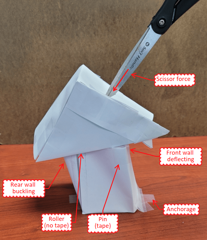

Since it's a flexible diaphragm, is it valid to assume that the wind would only get transferred to the (2) exterior side walls? Wouldn't the lateral force get transferred to the wall that the trusses are pinned to? My understanding of diaphragms wasn't that that directed the load to the outside of the building so much as they distributed lateral forces to the elements in proportion to the relative stiffness of those elements. I would contend that the side walls would have a lot more stiffness than the walls perpendicular to the force, but in my mind, it seems unconservative to neglect the lateral force acting on the perpendicular wall.
What I'm saying is, why not design the perpendicular wall to take up the lateral reaction of each truss, and why not design the side walls to half the total lateral reaction of the entire roof?
I just did a desktop experiment by making a house with paper walls and a paper roof. The roof has 3 "trusses" (they're actually just triangles) and a diaphragm. If I push on the center of the roof (directly on the center truss truss), the side walls take up enough force to cause the rear wall to buckle, but the front wall still deflects.
CrabbyT - in a hyper realistic sense, sure, it'll transfer to elements based on their relative stiffness. But in light frame wood construction, who has time to design like that? It's a flexible diaphragm, for distribution to shear walls assume the diaphragm has zero stiffness and the load is distributed based on tributary area alone. Then look at diaphragm as a structural element with reactions at those locations to determine shear in the diaphragm. But the lateral load is taken by the diaphragm to the shear walls - often the exterior walls.
Your model is neat, but the scale and materials make it invalid. The paper lacks the ability to simulate wood framing, and the proportions of your little house don't match the reality of any building I've ever designed.
All of that said, a positive connection of the roof truss to the wall is important. It should be fixed to prevent lateral displacement at both ends. The 'roller' effect comes not from actually releasing the truss reaction, but from the lack of lateral resistance/stiffness in the wall that is pinned at the foundation and pinned at the truss. The reaction shown on that truss diaphragm is more about the load delivered to the LFRS and not the load delivered to the wall. The wall delivers load to the truss on its way to the diaphragm.
