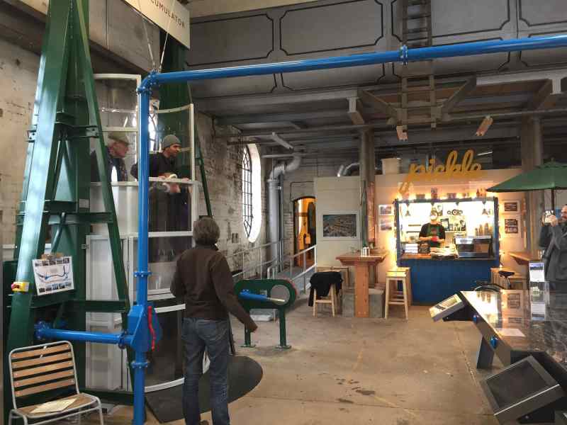

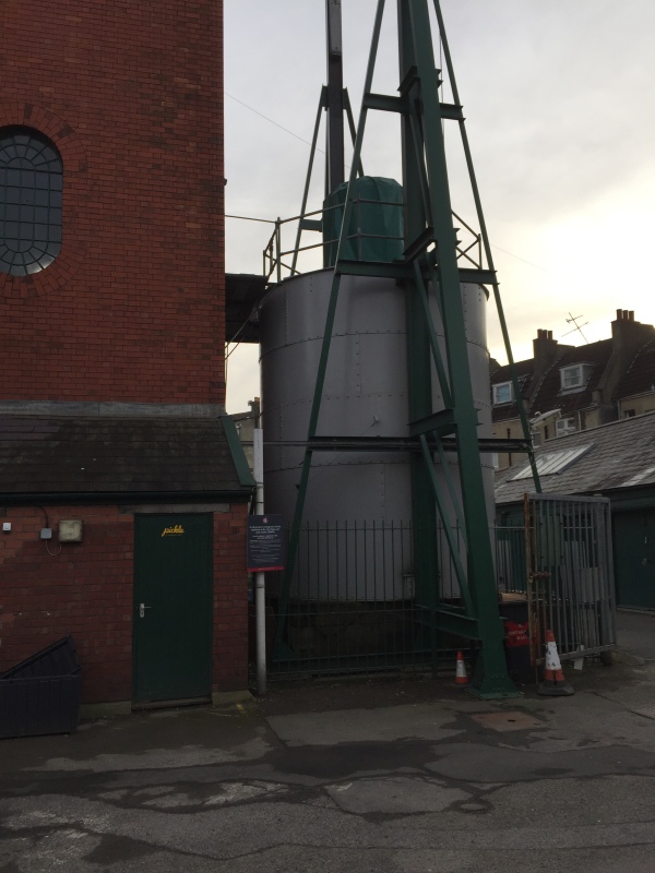

KENAT said:
if I recall correctly some of the early hydraulic accumulators did just use a mass on top of the column of water
You're right. There's still one like that works the machinery at Bristol Docks. There also used to be (may still be) one to lift the bascules at Tower Bridge in London.

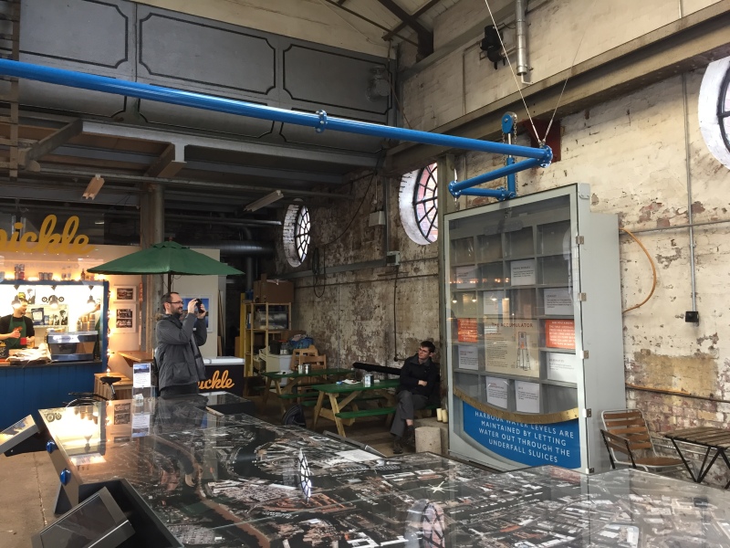

I was down at the Underfall Yard in Bristol just after Christmas and grabbed a photo of the old accumulator.
Round the back, they have a cafe with a working model. Various relatives enjoyed being pumped up and down to play the part of the deadweight.
