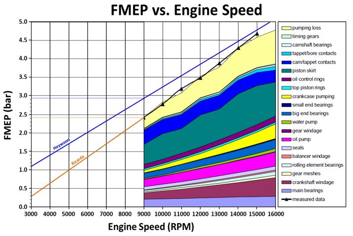

I assume the output speed is somewhat reduced by your cam arrangement - ie a piston undergoes multiple thermodynamic cycles in one revolution? (A conventional 2 stroke executes 1 thermodynamic cycle per revolution.) Your rpm and torque values would be more interesting if they were corrected for this.
EDIT. Just looked at your animation above and counted four lobes on your cam so 4:1 reduction?
Yes. I calculate work (Joules) for one cycle of one cylinder every fraction of a degree via pressure * change in volume then sum it all up. From that I calculate IMEP and subtract FMEP to obtain BMEP. I then calculate HP from BMEP using a power-pulses-per-revolution (PPR) value of 24 (6 cylinders x 4 power strokes per revolution).
As such, most of the columns in your comparison table above are quite meaningless - especially torque/displacement and torque/mass because you are comparing engines with different "internal gearing".
BMEP (specific torque) and specific power are much more useful for comparing engines - especially ones with completely different architecture.
je suis charlie

gruntguru said:
I still don't understand the torque/volume column. How is it calculated and what use is it?
It's torque per unit volume (aka "size"). Along with torque per unit weight, it informs me as to the competitiveness of my engine. Torque per unit weight is the more accurate figure because weight is easily measured and routinely reported. The torque by unit volume figure is less solid because, lacking an engine to immerse in water, it requires eyeballing and approximation from provided dimensions and drawings. That being said, it shouldn't be far enough off to explain why the T/in^3 and T/lb figures of the GF30, GF38, and G30 engines are out of whack. I suspect they may be pumping up their HP and torque numbers (model airplane engines are not routinely tested on dynos). As a very last step in the process, I may buy one each of those engines and throw them on my dyno just to get some good compartive data.
When calculating torque/mass and torque/vol, did you discount the torque from your motor by 75% to allow for the internal "gearing".
je suis charlie
I don't understand why you suggest I "discount the torque... by 75% to allow for internal gearing." The negative effect of my "internal gearing" is manifest in my FMEP calculations which average the Heywood and Ricardo estimates at 4x my RMP (2,626 x 4 = 10,504 RPM). As I have previously mentioned, this is only an estimate, but I consider it reasonable since Ricardo and Heywood both include sources of friction that are absent in my design. I plan to refine the estimate with measurements early in the critical experiment phase.
