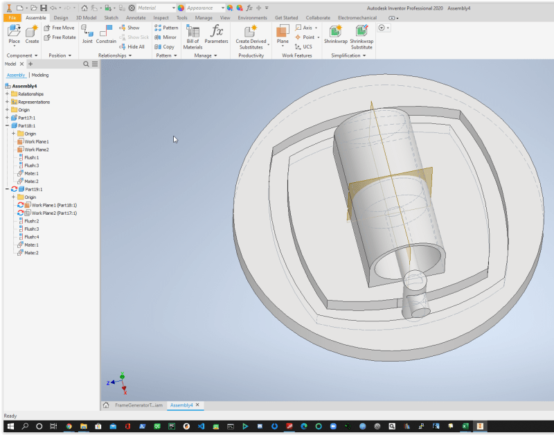

I am not very good at communicating without pictures, just imagine if:
There were a slot, there would be two sides, ofcourse, and a pin would ride in the slot. The movement of the piston could be controlled in both directions without a spring.
You could do this for every piston.
Because what about the top piston? Wouldn't there be centripital acceleration forcing it down, and where would be the return spring?
I imagine you could have a slot milled and have a rolling bearing riding in the slot if you wished. It'd have to be multiple at that point.
I just imagine your "cam" profile is probably a ground surface. It may be much easier to make a prototype with a slot and bearings, ignoring longevity.
I guess I'm not criticizing at all, just imagining how it could be made in a home garage, more or less, with a 2.5 axis machine you can find used for a couple hundred bucks. (is that the term for machines that can only move the x and y at the same time?)

michaelwoodcoc, Your illustration shows a slotted cam (albeit one with an extreme profile) which is what I mentioned in earlier comments. A few things to note, however. First, return force is far less than driving force, so the retracting pins need not have the same large radius as the driving face, and making them smaller decreases overal engine diameter. Second, a slotted cam still needs spring loading or it will chatter during direction reversal. This loading, however, is much easier to provide as the end-stroke loads are low and spring travel need only encompass the cam slot tolerance (~0.005 to 0.010 inches).
As for roller bearings... Even in the smallest version of my engine, the product of surface speed and load exceeds roller bearing capability, and the problem gets worse as the engine size increases. In addition, use of such bearings increases cost, complexity, and reciprocating mass. I decided to keep it cheap, simple, and low mass by exploiting the high surface speeds to keep a simple sliding cam operating in the hydrodynamic regime from idle to max RPM.
Yes, cams will be made of very hard (Maraging 350) steel machined, ground, and highly polished to optimize lubrication. I may even send the final versions out for diamond coating. Note that cam subsystem performance and life will be the focus of independent subassembly tests.
I am using a Microproto VSS MicroMill DSLS 3000AB equipped with the 4th axis and a Microproto VSS TaigTurn 2000AB for prototype work. I'm starting with a model machined from clear acrylic to check out CNC code and confirm everything fits properly. I will then *attempt* metal components for subsystem test. If I am unable to get the accuracy and surface finish I require on some components, said components will be sent out to a machine shop with the required capability. If nothing else, I figure my acrylic model will ensure the engine is machinable and that everything fits properly so I can minimize the number of costly iterations I go through at an external machine shop.
