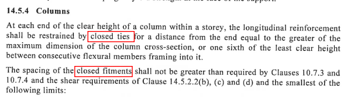

The 2018 code now states that ANY wall 65MPa or great must comply with Section 14.5.4 regardless (refer 11.7.4 & 14.6.3). 14.5.4 states that any (wall) with N*> 0.65x0.3f'c must have each longitudinal bar restrained by a "closed fitment".

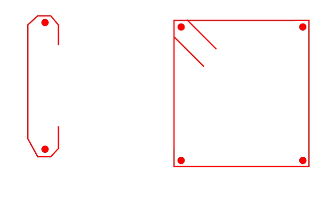

Firstly, what denotes a closed fitment?
I have always thought that 'closed' referred to a fully enclosed shape detail with typically two 135 corner hooks. Section 14.5.4 refers to 'closed ties' and 'closed fitments', both of which have separate definitions in Section 1.
Section 14.6.2.2 refers to 'closed stirrups', which isn't explicitly defined in Section 1, and Figure 14.6.2.2 shows what I typically think of as a closed fitment/tie/stirrup/ligature.
Section 14.6.2.3 refers to 'closed fitments' but Figure 14.6.2.3 draws single leg ties with 135 degree hooks at either end. Figure 14.6.2.3 also refers to them as ligatures/ties.
My point to all this is that 14.5.4 is very onerous for 65MPa or greater walls with N*>0.2f'c. Whether a 65MPa wall is designed for ductility or not, CL14.5.4 still applies.
Secondly, if a wall requires a lot of steel for tension, that's a lot of bars that need to be restrained. Is the only real option here to have an inner layer of 'tension bars' and an outer layer of restrained bars confined in the core to avoid having to tie every single bar, if the bars are only in two layers?
Thirdly, is a single leg tie with two 135degree hooks considered a 'closed tie'?
If the ties have to be as per Figure 14.6.2.2, this is extremely onerous on site for the steel fixers. Figure 14.6.2.3 is not as taxing, but still not as convenient as the internal ties shown in section 10.

But the same clause refers to both 'ties' and fitments'.
I don't understand if I'm allowed to use open (C-shape) ligs or not? I really don't want to show fully closed (O-shaped) ligs everywhere.
A Tie is defined as a single leg with 135 degree hooks on the ends.
A fitment is one or more units of reinforcement developed with 135 degree hooks on the ends.
One of or a group of "units of reinforcement" of which Ties are a type make up a Fitment.
So in 14.5.4 its use is interesting. The first "closed ties" being plural is a Closed Fitment. So technically correct both ways, but I agree the first would be better as Closed Fitment.
Second is correct.
As you move down the clause,
(b) should possibly be "fitment bars" as a fitment is made up of bars.
The sentence after (d) should probably be Fitment, not Tie.
The next sentence is probably correct at "fitments" if it is talking about the total wall/column, or "Fitment" if it is talking about each set.
The last sentence should probably be Tie as it is talking about restraining an individual bar, but could also be Fitment as a Fitment can consist of a single unit.
But in any case, they all need 135 degree hooks if f'c > 65MPa.
And alternate 90 and 135 degree hooks if f'c <= 65MPa. But if you use this detail, consecutive "ties" on a longitudinal bar must have 90 and 135 degree hooks, so you have to make sure the installer alternates the 90 degree and 135 degree ends over the length of the bar. Good luck with that on site and in checking it with the forms in place! I would be using 135 degree everywhere.

in summary, do you think we can use the open C ligs or do we need to have it fully closed?
if it's the latter, can we use 2x C-ligs to close the loop?

Does your open C leg have hooks at one or both the ends of the legs? If not, I don't think that detail would have ever been acceptable, new or old code.
Look at clause 10.7.4.2 text and the Fig 10.7.4.2.
A C leg with 2 135 degree bends is closed. With 2 90 degree bends is presumably "open" and not allowed. There is a dispensation to allow alternate 90/135 bends for f'c <= 65MPa.

Hi Gishin, thank you for your response. What is the justification behind single leg ties with hooks on both ends being compliant with 14.5.4? It's still unclear as the code references both closed ties and closed fitments within that clause.
I believe Winston's case is similar to the first image I posted before with hooks at both ends.
16.2.3 specifically says for Boundary elements detailed in accordance with 10.7.4, of which 10.7.4.2 is obviously a part and gives the rules on column "Ties/Fitments".
14.5.4 is not quite as specific as it references 10.7.3 and 10.7.4 for the amount of ties required but does not specifically mention detailing of the ties/fitments except that it has the 65Mpa rule requiring closed fitments (a tie with 2 135 degree bends is CLOSED according to the definitions). I will get that confirmed but it would appear logical that it is also controlled by 10.7.4.2.

If you read back through this post, specifically at Rapt's comments, you'll find the justification. Figure 14.6.2.3 also makes this clear.
My main take from this is that a single leg tie is acceptable if both ends are hooked, and therefore anchored into the core of the wall. A 90 degree cog doesn't work as the cover concrete is blown off at ULS. 3600 has always noted this in the beam shear section as well.
