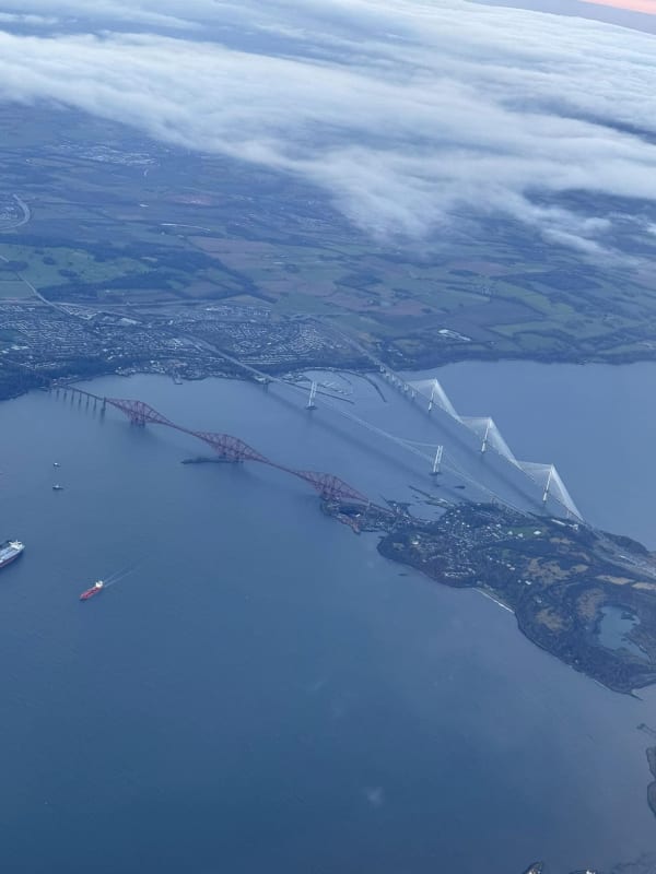

as the Forth bridges have been mention.
Risk analysis of a similar event.
