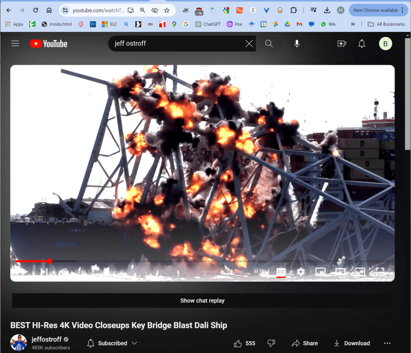

Just as a point.. When they say charges and detonate it will be cutting charges. /quote]
They were actual explosive charges, as shown in Jeff Ostroff's latest video

The set up is a V with copper wire which gets turned into plasma that actually does the cutting. Its not a colossal bang (well it wasn't when i did it).
Wouldn't the noise from each cutting charge be directly related to the thickness and width of the metal cut? May explain a noisier event than expected.

Boom may be a better word. There would be less boom with shaped charges because they don't take a lot of propellant. They do, however, benefit from a very fast burning propellant as their cutting action is velocity based. This would make more of a bang.

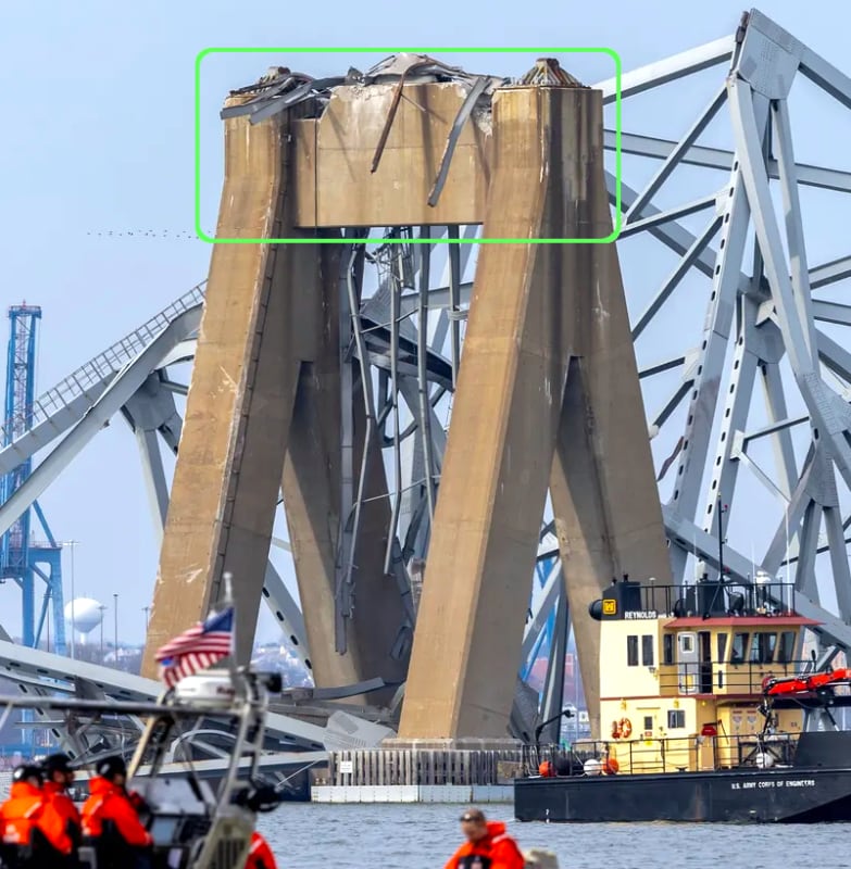

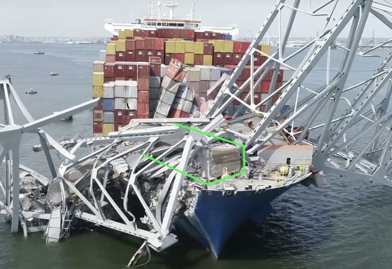

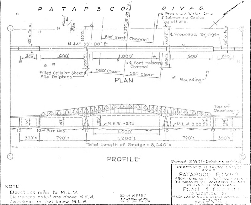

On another note - Bridge blueprint
The pier header, a solid mass of concrete approx. 80' x 23' x 13.5' (roughly scaled from photos, Google Earth, etc.), rests on the deck of the Dali under the roadbed. Only one end is visible in the debris.
bearing seat at left (maybe 9' x 9')
Between that concrete mass, and the residual truss structure still resting both against and on the bow, the task of safely clearing the ship could take longer than assumed.
