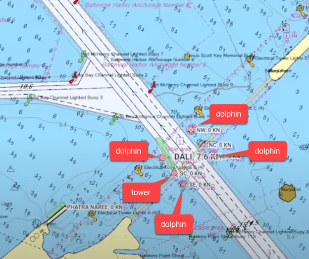

Here's a call for action on bridge protection, mainly bigger dolphins and more of them, an article by our author and resident civil engineer/bridge inspector, Joshua Sadlock. I helped with some of the writing. Let me know what you all think.
Roopinder Tara
Director of Content
ENGINEERING.com
RoopinderTara said:
Here's a call for action on bridge protection, mainly bigger dolphins ...
By coincidence new 80ft dolphins are currently being installed nearby for Delaware Memorial Bridge over the Delaware River. The bridge is massive, and MV Ships travel under it to major ports in Philadelphia. Dolphin design details:
Kevin Kelleher, P.E. (retired)
Internal Mechanical Eng'g Consultant
DuPont ESD Specialists
I'm concerned that the dolphins can stop the ship but then tear into the hull in a way the overhanging portion still reaches the bridge pillars.
That's ok. These ships are operating with very little under keel clearance. If you tear a hole into the hull and sink the ship it will likely end up only a few feet lower than it was when it was floating.
I think that the article touches on that; the dolphins have to have some give, like crumple zones; ripping the the bottom out of a ship and sinking it isn't exactly a win-win.
TTFN (ta ta for now)
MV Dali had the hull torn open and did not sink because of it; sinking is not a problem that needs addressing. Refloating a ship that is a few feet lower in the water than normal isn't a huge problem and, as in this case, if it sinks because the ship was not seaworthy? Shug.
