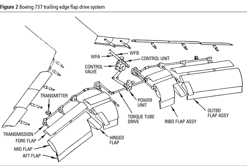

FAA just released an AD to inspect the flap synchro wire on all classic variants.
What it does I have no clue
synchronises the flap, of course...
...lest they function as ailerons
nah
They are run off torque tubes and hydraulics on them, there is asymmetry sensors which will cut the hydraulics and lock them in place if the torque tubes break. But its a electrically controlled mechanical hydraulic system.
Its more how the flaps would have a link to the auto throttle.
Question, can a 737 land without with 0 flap as in the system has failed to operate?
yes all aircraft can. You are going significantly faster than with them. Almost but not quiet exceeding the tyre limiting speed and you need an extremely long runway. And its part of the 3 year cycle in the sim for pilot to land without them.
I have only had to do it once in real life but that was with a turbo prop Jetstream 32 which is certified to land zero flap normal operations but we never did because it eats brakes and tyres . Normally with that we would use 900 meters of runway flap 25 with zero I used over 2000meters and had full beta rev in down to 70 knots. With medium jets its classed as a none normal emergency procedure and your talking over 3000 meters of runway. The heavy's its a major emergency and will more than likely leave you with a plane with tyres blown out possibly on fire and in the retard zone off the end of the runway.
