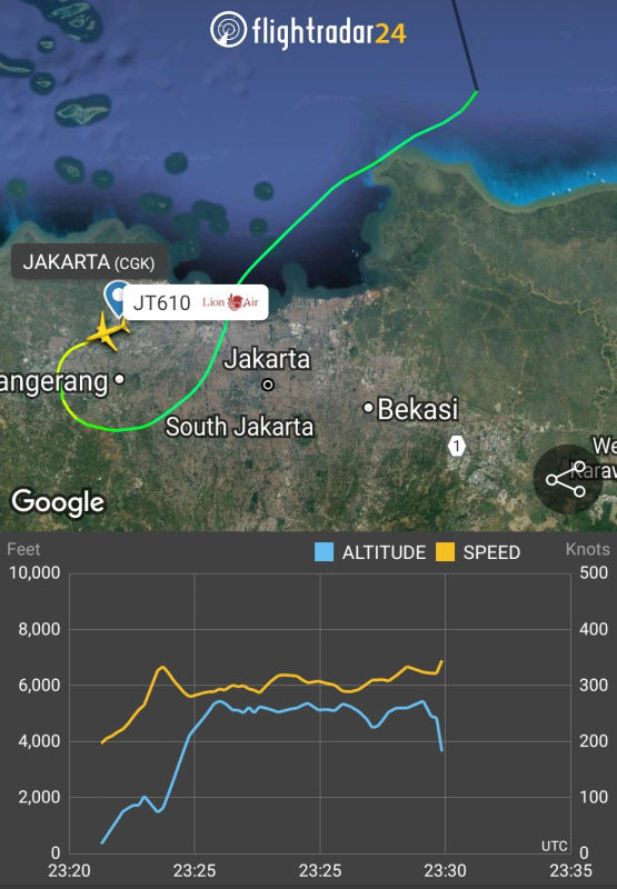

Indonesian 737 Max 8 - Splashed
Most reports I've seen mention the aircraft had an 'undisclosed issue' before take-off. Does anyone know what that was?
Surely the crew was in contact and reporting something during the relatively long disaster.

How exactly the LionAir 737's AP could have gotten confused is not yet clear to me, even with the text of the AD to refer to. It seems a declaration that the AP system's functional hazard analysis has been found to be invalid, or relied on a backup source that doesn't do what it's supposed to. The AD says nothing about the configuration of the AP system, as if one faulty sensor should be expected to provoke a wild ride. It absolutely should not. The text of the AD makes mockery of a reliability requirement that has been standard practice in flight system design since the 1960's.
Part of the functional hazard analysis (FHA) for any critical flight system is the need to identify faulty readings, and disregard them. The resolutions become built into the design and programming of the system.
The Autopilot system must be programmed to compare, select, filter, or vote in some way that deals with bad sensors, otherwise the moment your anti-icing system fails you go into a spin. All of the sensors are backed up with at least a duplicate, and wherever possible a completely alternative source that can reconstruct the same information. AoA can be measured directly from AoA sensors (the 737 Max is typical, has two of these, one on each side of the cockpit) and a couple of inertial navigation units (INU) within (probably) more than one attitude and heading reference systems (AHRS). There may be other ways; I'm not a sparky. I do not know what system is on board the 737 max, so I do not know what it actually uses for backup data. But the requirements of FAR 25.1309 speak for themselves, and no single failure may pose a hazard to the aircraft.
I would like to know if sensor de-icing was turned off, or malfunctioning at the time. The flight crew would be aware of either conditions, if they were happening. Since the text of the AD doesn't demand examination of the de-ice, or admonish pilots to keep it turned on, this may have been checked already, and ruled out.
This AD sheds no light on what happened, to me. Raises more questions than it answers.
