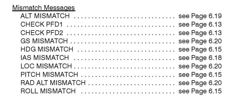

I assume there is an alarm or message to the crew that there is a discrepancy between primary and backup sensors. I set up controls this way when 2 sensors for the same parameter are available. Maybe it's an oversimplification of the actual subsystem, but it seems that this should alert the pilots that a sensor is malfunctioning and then they should have the option to select the one which seems to be correct.
Brad Waybright
It's all okay as long as it's okay.
Not that I have heard of with the AoA sensor...
That's what I have for sensor errors. Your not given AoA data in the cockpit as a raw value. You can see it changing by the red stall indicator at the bottom of the speed tape so I suppose if the pilots compared the red zone on the speed tapes you could spot a problem. But its not something you are currently trained to do. To be honest I wouldn't like to say how many pilots might not make the link between the red tape and it indicating angle of attack. And mid struggle trying to keep the nose up it would be hard. Must admit I give the AoA vanes a waggle every turn round and only once found something not feeling right, it was swapped out before the next flight. But a lot of aircraft you can't reach them from the ground so would require a cherry picker or set of steps.

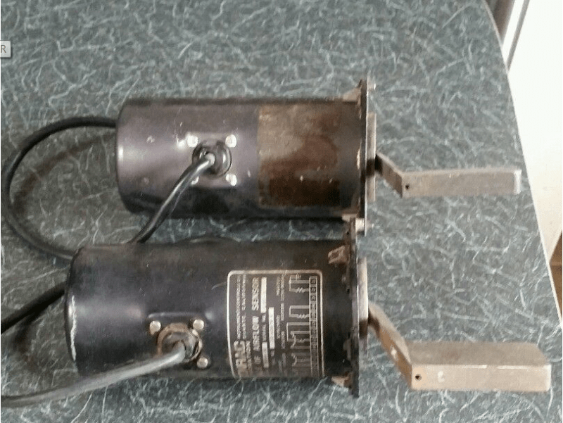

Are these things handed somehow? or are there two one above the other on a 737? I can't imagine that they aren't somehow physically fixed in the same way so that zero degrees is the same and you can't rotate the thing one bolt hole by accident? Could you?
This photo purports to be two B737 AoA sensors and I can't see any fitting which wouldn't stop it being rotated incorrectly.
I doubt very highly that they need mechanical clocking.
Dollars to doughnuts, that body contains an incremental rotary encoder which is re-zeroed whenever the system is powered up.

you can see the circuit diagram on the side of it. Its just a potentiometer.
They usually have a couple of bolts out of phase with the rest and lugs at funny angles so they can only be fitted the right way and on the correct side.
Plus also there will be a part number check with the old one when its replaced.
And they don't sit at zero when the aircraft is powered up for a bite check. They can be at any angle mainly due to local wind conditions. Still winds they will at the bottom of travel and 40 knts of wind on the nose and they will have lifted.
Actually, I believe it is a resolver. Either way, whether left or right, swapping polarity of supply power would provide duplicate signals from each side, whether degrees down, degrees up, or neutral would be the same so the sensors would be identical.
