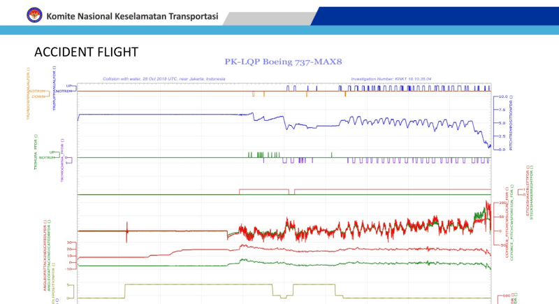

Another 737 max has crashed during departure in Ethiopia.
To note the data in the picture is intally ground 0 then when airborne is GPS altitude above MSL. The airport is extremely high.
The debris is extremely compact and the fuel burned, they reckon it was 400knts plus when it hit the ground.
Here is the radar24 data pulled from there local site.
It's already being discussed if was another AoA issue with the MCAS system for stall protection.
I will let you make your own conclusions.

The MCAS has been designed to trim the plane to nosedive 2.5 degree each time for about 10 sec and then rest for 5 sec. In the original setting MCAS is allowed to activate unlimited number of times( see graph below for the 20+ times in the doomed Indonesian plane recordings). So it takes about 3 activations and the horizontal stabilizer could be at its limit. In the presentation released by Indonesian Aviation Authority KNKT the blackbox data shows pitch trim position was advanced by 5 degrees before the plane impact. According to the explanation by the experts the 1st graph represents the manual trim by the pilot while the 3rd graphs by the MCAS response and the 2nd graph is the pitch trim position.
The new setting permits MCAS to activate only as a once-only event at a time and to take reading from two instead of just one AoA sensor.
MCAS was triggered by a defective AoA sensor in the Indonesian plane. No information is available from the Ethiopian accident yet (due this week). Thus many Max flew without incidents in the USA because the planes did not have fault with the AoA sensors. In any case the MCAS can be disabled by a kill switch if any 737 pilot equates its effect as a standard runaway trim. That was FAA's defense used in the Senate hearings yesterday.
