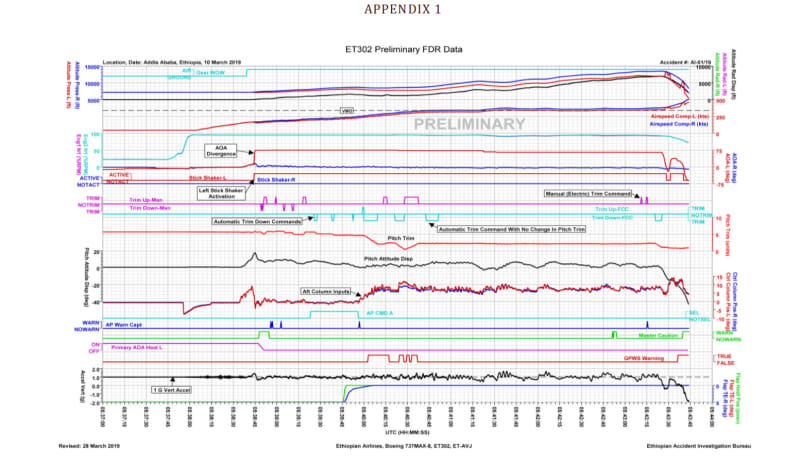

There are still some mysteries in the ET302 FDR from the report
(1) A huge 75 degree disagreement between two AoA sensors (In Indonesian plane it was 20 degree). What could cause such huge disagreement and sustained 60 dgree to the end and then with a sudden swing, from +60 to -60 degree?, just before the plane hit the ground ? In both crashes it was the Left AoA faulty but in the Indonesian case the fault stated immediately.
(2) The MCAS kicked in initially with 3 small Automatic Trim Down Commands changing the Pitch Trim from 6 to 5 degree over 12 seconds. It then followed by two 3 and 2 sec aggressive Automatic Trim Down Commands to reduce the pitch Trim from 5 to 0 units. The pilots immediately counteracted with Manual Trim up to pull the Pitch Trim back to about 2 units. At the same time both pilots were heard to apply and confirm the Stab Trim Cut Out switches. Thus the aggressive third long 4-sec trigger by MCAS at 05:40:45 did nothing to the Pitch Trim. However the last Automatic Trim Down Command, at about 05:43:20, pushed the pitch Trim down beyond the point of recovery. Was this a design flaw in the system or the pilots had reversed the Stab Trim Cut Out? If it was an action by the pilots the voice recorder would have a record similar to the one occurred previously and stated in the report "At 05:40:35, the First-Officer called out“ stab trim cut-out” two times. Captain agreed and First-Officer confirmed stab trim cut-out."

saikee119 - You missed that the pilots did 2 short trim up commands which did move the stabilizer starting at 5:43:11 - about 2.5 minutes after the stab switch call-out in the CVR and the MCAS trim down command not moving the stabilizer. Both the pilot trim switch and MCAS became function again about 2.5 minutes after the stabilizer switches were cutout. This tends to disproves any conspiracy that the MCAS was left functional even in stab cutout.
Why the stabilizer started moving electrically again might be one of the toughest questions to answer.
Why the pilots could recover from the second automatic stabilizer movement to 0.4 units and not the 4th and last automatic stabilizer movement to 1 unit will be another tough question to answer.
One speculation is the Ethiopian pilots had applied the Cutout switch to the MCAS but might have switched it back again. It is this point I like to see the views from the members here.
The observations are:
(a) The report states “At 05:40:35, the First-Officer called out “stab trim cut-out” two times. Captain agreed and First-Officer confirmed stab trim cut-out.” Since both the CVR and DFDR have been recovered and available to other agencies so the information is no longer private. If a voice recording can be heard for applying the Cutout switches once one would expect the same should be available from the pilots for reversing the Cutout switches.
(b) It is somewhat unimaginable that the pilots, knowing well by heart that MCAS can cause the plane to node dive, having killed off MCAS with the Cutout switches to fly the plane if not steady but slowly upward and gaining altitude progressively over a period for nearly 3 minutes would suddenly had a dead wish to activate the MCAS again themselves without recording their action orally.
A possible explanation behind the pilot might have inadvertently switched on the MCAS can possibly explained by Peter Lemme description of the differences of the Stab Trim Cutout switches between a normal 737 and the Max model.

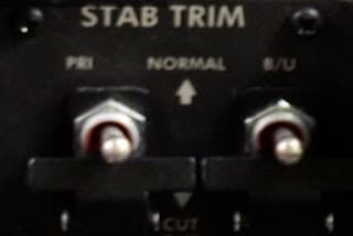

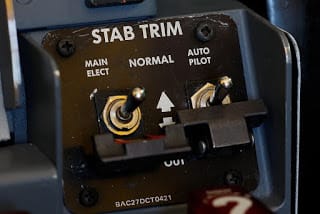

In a normal 737 that most pilots fly one of the Stab Trim Cutout switch is to disable the autopilot and the other is to disable the electrical power to the Electric Trim. Just flip the autopilot Cutout a pilot can disable the MCAS (if fitted) and still be able to use the electric trim to control the plane a lot easier than just use the manual trim.
In the 737 Max the two switches are marked a PRI and B/U. Peter Lemme was asked about what these refer to and he guessed Primary and Back up but was unsure what their functions are.
If the Ethiopian pilots, familiar with the non-Max version of 737, had flipped just one of the Cutout switchs thinking it was Main Electric to restore the electric trim then that would have let the MCAS slip through the net. (FAA Emergency Airworthiness Directive mandates MCAS must be disabled by applying both Stab Trim Cutout switches)
It is evident from the black box data after the pilots applied both Cutout switches the plane was steady up to 05:43:10 without any electrically-assist manual trim while the aft columns were worked on continuously. If the pilots needed a relief to their workload and mistakenly thought to reverse the Cutout switch normally for restoring electrical power in a non-Max 737 then we could see some electrically-assist manual trim events in the black boc data. This is indeed the case. The report at 05:43:20 shows two such electrically-assist manual trims did occur, as pointed out by LionelHutz.
About 5 seconds after the last electrically-assist manual trim the restoration of electrical power also allowed MCAS to activate itself from the faulty AoA left sensor. It is that last 5 to 6 second MCAS activation that pushed the nose down beyond the point of recovery and destroyed the plane.
Like everyone I am just speculating but the black box data does support this theory.
