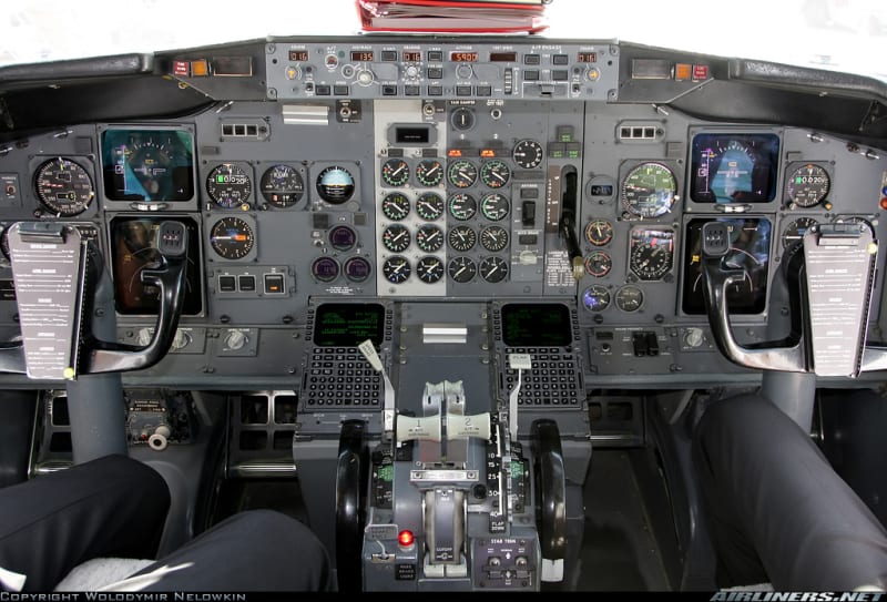

Here's a photo of the relevant controls:
This picture was taken just a few years ago from a 737-400. As you can see from all the glass, it's had an avionics upgrade, but the basic flight controls remain the same.
The 737's all have stabilizer trim wheels on either side of the center console to allow the flight crew to make manual adjustments to the stabilizer. These adjustments are unnecessary when the autopilot is on, and moving the wheels can actually disable the AP if it is.
In the lower center of the photo, you can see the pair of STAB TRIM switches. If they are set to CUTOUT then the autopilot and hence approach coupling cannot engage. Also disconnected by STAB TRIM CUTOUT is the MCAS. What remains available, however, are the manual trim, MACH trim and the Yaw dampers.
Mach trim does what you might assume it does: adjusts the trim slightly for the effects of high speed (the 737's fly up to Mach 0.85 or so). The Yaw dampers compensate for oscillations in the aircraft's lateral direction which happen when slight adjustments are made to its direction. There is no need to override these if the stabilizer trim has trouble (and reasons why you don't want to either).

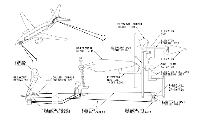

The aircraft stabilizer and elevator work in a dependent-independent relationship. The stabilizer is the "entire" horizontal tail, which can pitch up or down several degrees. You can see the marks on the fuselage this travel leaves on every 737. When the stabilizer moves, the elevators moves, too. Their relative movements are complex:
(The above photo is from a 737-200. Sorry I have no 737 Max schematics. It is my belief that much of this system is similar on later aircraft, including the Max, but I admit it's an assumption on my part.)
The main driver of the horizontal stabilizer is the trim actuator, which is a screw-jack. It receives commands from trim adjustment wheels on the center console. My understanding is that on the Max, an additional input to this actuator is sent from the MCAS system. When active, the MCAS will move the actuator, adjusting the stabilizer pitch up (which pitches the nose down) and the crew should expect to see the stabilizer wheels spin at the same time.
The elevator is the movable trailing edge of the stabilizer. The main control Yoke operates the elevator, and it is quite true that this is done by steel cables. So when the flight crew "pulls back on the stick" they are indeed pulling on cables and directly moving the elevator. You can also see from the schematic above, there are other systems acting on it, including the mach trim and the autopilot actuators. These make adjustments relative to the position of the cables from the yoke, and the elevator can move under autopilot control without the yoke showing any corresponding movement.
So going back to what happens when the STAB TRIM is set to CUTOUT, the autopilot actuators on the elevator stop working, and so should the MCAS control over the stabilizer trim. But all the other controls do still function.

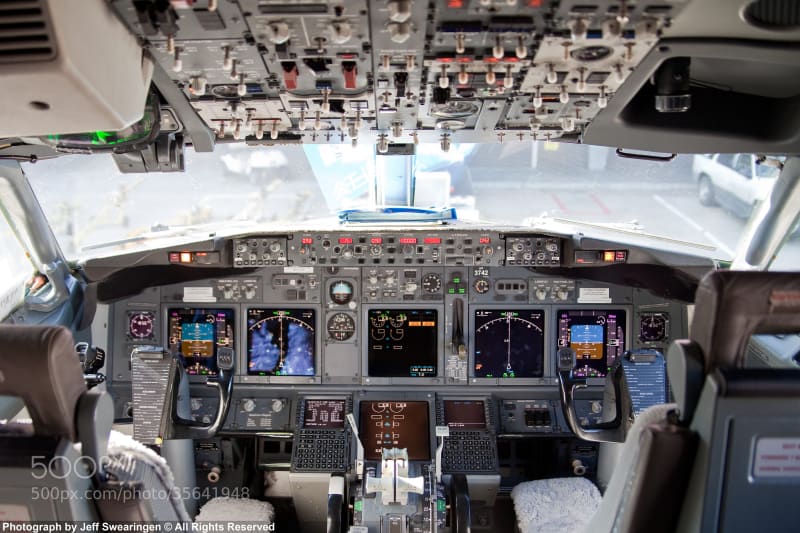

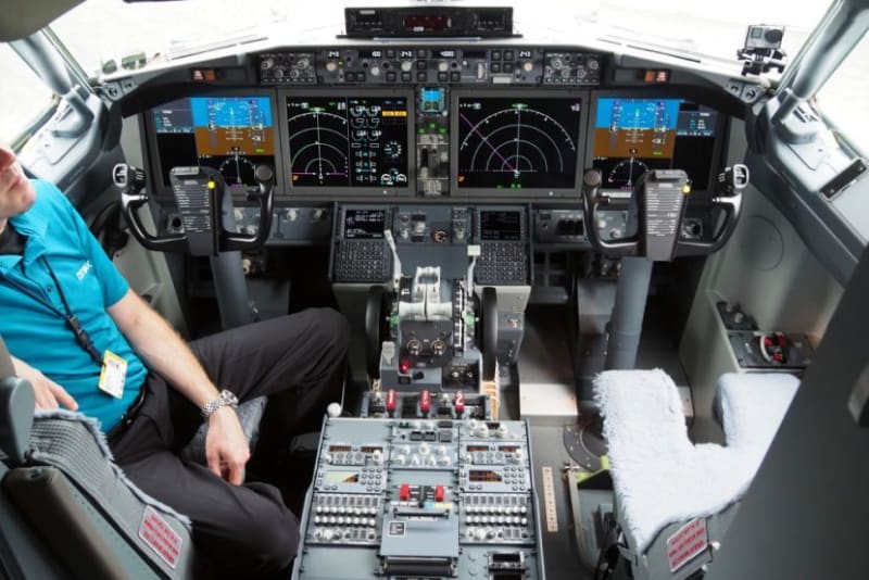

There was an issue with my registration apparently. I would like to state I am not pro any manufactures product, most of my time has been spent in a Handely Page designed aircraft aka the designer of Lancaster Bomber. Built like a brick poo house, lovely to fly but ultimately an under performing heap of an aircraft which realistically shouldn't be flying with paying pax on board these days. The aircraft I really really want to fly is the Boeing 757 with Rolls engines sometimes called the 75 GTI in piloting circles. So I am not anti Boeing in the slightest. But I do think a pilot should be given a safe aircraft with which to operate. My disgust is firmly towards the regualators allowing this situation to develop. And its not just targeted at one countries regulator, world wide they are all as bad as each other these days. They have all de skilled and turned into paper work chasers over the last 20 years. But I am sure sparweb has more experence and knowledge on this subject than I do as a stick monkey. BTW the stick monkey comes from an old bit of banter between Pilots and Technicians. The techs say you can train a monkey to ride a bike but you can't train one to fix it.
This is a 737-800 NG cockpit.
And this is the MAX.
"It is my belief that much of this system is similar on later aircraft, including the Max, but I admit it's an assumption on my part."
Its the same, a physical change to the control system would be a step to far for a straight through grandfather certification. It would also trip the balance between new type rating and differences training. I will try and find out if it changed between Classics and NG.

SparWeb - Any data I have seen says the cutout switches disable electrical operation of the stabilizer trim actuator/jack screw. Yet the report shows that the trim actuator/jack screw moved electrically right before the crash. 2 small nose up movements from pilot input and a big automatic nose down movement (presumably MCAS). It's rather hard to reconcile these movements unless the pilots had moved the switches again.

It appears that the manually trimming the plane by the crank wheels, when the plane is out of trim in a nose dive situation, doesn't appear to be a viable solution. The Senate should ask FAA/Boeing to demonstrate how it is done.
