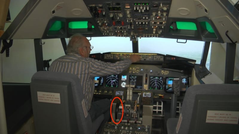

I understood that the Trim Wheels on each side of the center pedestal plainly rotate when the trim is in movement, from any cause. If there was anything wrong with the crew reaction, then it's probably not from missing the two spinning trim wheels.
So this theory would need further work.
The trim wheels do turn when the automatic or electric trim adjustments are happening. They spin rather slowly but are marked with a white stripe to make the movement easier to see. Their location, however, isn't really in the direct line of sight all the time.
With a big 'ol adrenaline hit, confusion in the cockpit, stick shaker whacking away, cautions/alarms/vocalizations sounding, and the rapidly approaching ground quickly filling the view out of the windows, yeah I think it's feasible that movement of the trim wheels would be easy to miss.

How do the pilots stop the powerful trim motor with their hand on the trim wheels?
There's a gearbox which mixes inputs from the hand wheels and motor, and outputs to the jack screw. The torsion coupling inside decouples the drive motor from the jack screw if a certain torque input is applied by the manual trim wheel. It's like a mechanical relay.
by all accounts using your foot is quite successful for stopping the trim wheel on the 737. If you use your hand your going to loose bio mass and add blood into the equation.
When the trim wheel goes its very noisy and gives huge vibration right next to your knee. And if your knee is against it when it goes you will be limping for a few days afterwards.
