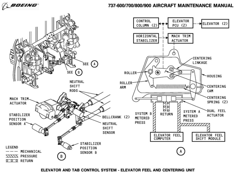

Hi VE1BLL;
This post is part of the discussion on simulators versus real world control forces and the generation of the feed back forces related to elevator action.
As I understand the drawing and the related information in the link that you posted, without compensation of some sort, when the stabilizer is moved the elevator would stay at the same angle to the fuselage. The connections between the stabilizer and the elevator linkage called the "ELEVATOR NEUTRAL SHIFT RODS" has the effect of keeping the elevator at the same angle to the stabilizer.
If the elevator PCU were anchored inside the rear of the stabilizer this compensation would probably not be needed.
Boeing chose to anchor the elevator PCU inside the fuselage and compensate for stabilizer movement.

As for and elevator feel computer, does anyone actually think this would be a sophisticated electronic device on a plane that went into service in 1968? Feeling the force via a device that takes the mechanical and/or hydraulic pressure required to hold the elevator in position as feedback sounds about right considering the tech available at the time of the 737 development.

Just to make my point about this "computer" clear - I would bet against it being electronic. Trying to say that it's an electronic system because you read the word "computer" and then further implying that Boeing stupidly screwed up the simulator because it should have been easy to transition an electronic algorithm to simulator land is silly conjecture when you have no clue how the whole elevator system actually works.
That's why I didn't comment on how it's possible that the trim wheel could over-ride the electric motor even though the electric motor can provide more turning force to the jack screw. I don't know why and it's pointless to post random conjecture to try and explain it.

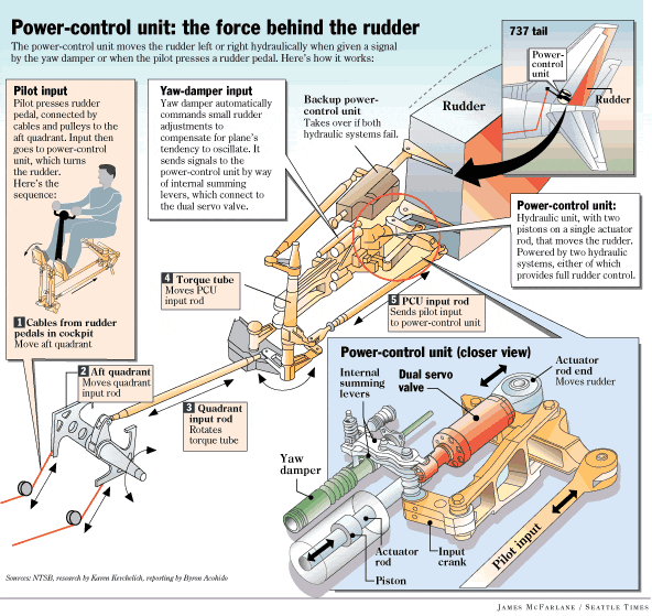

Bill - doesn't really matter, I still don't see the whole point of your blurb about power steering or the grader without a steering wheel since none of it has anything to do with how a 737 works. Besides, I think you're reading that statement way, way out of context.
The PCU is nothing special to be honest and does work on the same principles as power steering but has a couple of other inputs which are electronically calculated ie the yaw damper to stop dutch roll.
I can't find a diagram of the elevator system but here is the rudder PCU set up.
The elevator per say is not trimmed its the tail plane/horizontal stabiliser which is moved for trimming via the screw jack. This then sets the base point and the elevator allows input from there.
A common misconception is that trimming sets a control force for an attitude its actually trimming for a speed at which the control forces are zero at a given power setting. It doesn't set an attitude.
Because the PCU gives through direct control as well the amount of additional power it can give is linked to the piston size and hydraulic system pressure which is 205 bar.
The only additional inputs for the elevators is the mach trim and feel unit. The mach trim compensates for mach tuck and lifts the nose. At the levels that the incident occurred I wouldn't expect it to have got involved as they wouldn't have got over mach 0.6 even at 400knts. The feel unit is electronic controlled these days and it will increase the resistance to pilot input as the airspeed increases. This is the diagram for that system for the NG. Its also hydraulically powered. It would have got involved as the speed increased opposing the input of the pilots. But the base setting is the AoA of the tail plane/horizontal stab.
The area of the stab is 32.78 sq meters and the area of the elevators is 6.55 sqr meters. You can't really give the elevators more power or increase the size because the loads will go through the roof and there will be a huge weight penalty for beefing everything up to take the loads.
I can only comment on my own type which has a fixed stab but if the feel system goes off line the autopilot is then off line and your limited to 200 knts and you have to be extremely carefull you don't bend the tail. And it feels extremely wierd while your hand flying in fact its easier to fly it via the trim instead of direct control inputs which is usually extremly bad practise. Personally I use a thumb and index finger touch on the control and then adjust with trim. 12 mile finals and stabilised fully configured and trimmed by 2000ft. The last TRE that gave me that exercise said I know your flying by trim I can see it on the board but I can't argue with the results so we will leave that debrief point at that.
