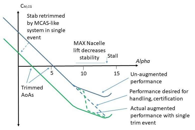

Speculating, not knowing, I will offer this opinion, based on a curve that circulated on the internet several months ago. It looks plausible, but the source is not confirmed to be valid, therefore this is NOT factual. Just some ideas, related to this question:
This curve represents a pitching moment curve, which is the moment that is counteracted by the tail. The moment must be counteracted by an opposing force at the tail for the aircraft to maintain any constant angle of attack. Trimming the tail changes the angle of the tailplane, which forces the aircraft to assume a different "trimmed" angle of attack. Usually this is done in very slight increments, not the exaggerated change in the graph above.
The graph shows several different pitching moment curves, intended to illustrate someone's attempt to explain how MCAS works.
1) the blue dashed line represents the preferred pitching curve which is linear and consistent through most of the flight envelope,
2) The blue solid line represents the pitching curve that may have resulted from the 737 max engine configuration change,
3) The green solid line represents the 737 max pitching curve after it shifts with a change in tailplane trim pitch,
4) The green dashed line represents the transition from one pitching curve to another as the MCAS operates to add some tailplane pitch.
So the graph seems to have some exaggerations, but it's useful to show how the system might be functioning. A few adjustments to the rate of MCAS pitch changes would allow the green dashed line to follow the blue dashed line more closely. As it is, I believe the graph is just printed the way it is for illustration and clarity, not to correspond to any actual data points. Another possible consequence of this kind of pitching behaviour could be that the control forces get lighter at higher angles of attack; another thing that corresponds to the reports we are hearing.
I hope you find that helpful, and answers your question.
