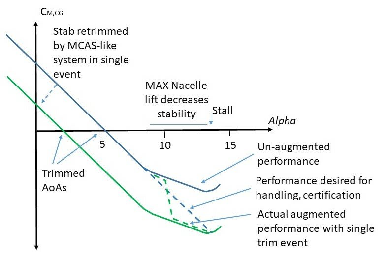

MCAS was added as a patch because at high alpha (unknown how high?, how near critical alpha?) the stick feel was not sufficiently increasing in proportion to alpha. Or was it alpha was no longer linearly reponsive to to elevator input? Since it's full hydraulic this begs the question 'couldn't they modify the artificial feel unit instead?'. Taken at face value, since stick feel is a stall avoidance input to the pilot, if it looks like a duck and quacks like a duck, it's a duck.
You've all got the picture, AFAIK. It's not about the stall or the angle of stall, it's about the slope of the curve approaching stall that's non-linear. Without a feedback system, a pilot could pull back by 1 inch with added 1 pound of force to keep it back, but the next 1 inch back would take <1 pound to hold. If at some point you can pull back another inch with nearly zero additional force, then the control feedback vanishes and the confusion begins. Pull it back 1 more inch, and you will need -1 pound to keep it there, and now confusion rules.
This figure was posted here many months ago but since the topic has come back...
It shows that the feedback is linear but not at high angle of attack. Nose-down is positive in airplane pitching moment terms, so that's why the trend goes down (nose-up). The graph also shows the complication of the MCAS adjustment that puts the feedback force back closer to the original linear trend. As with any non-PID feedback control, using discrete lumps of negative feedback leads to zig-zag trend lines.
LittleInch.
The point is that there is no force feedback in normal flight. The force on the stick is generated artificially by the force computer.
A dependable AoA signal could have been used to bias the force computer.
The force on the stick relative to the elevator deflection could have easily been adjusted to much less and still been proportional in accordance with the regulations.

Ok, I got this wrong. The issue as I see it now isn't so much the feel of the stick and elevator ( which is more artificial than I anticipated ) as the fact that as you get to about 10 degrees AoA the position of the stick is no longer proportional to what the airplane wants to do.
i.e. up to about 10 degrees as you pull the stick back for every inch you get a similar effect in terms of AoA. The issue is that above 10 degree this effect changes and for every further inch back the plane stops responding in the same way and the elevator has a lower effect than before. Hence for the same amount of stick movement the AoA increase faster.
So to make the plane respond in the manner sparweb quotes, they needed to counter the lift being generated by the engine nacelles and the way they chose was to use the large stabiliser to counter this and allow the elevator to be the sole/ main input into increasing AoA.
My main point is that this is so fundamental to the design of the aircraft that given its age of design and lack of the required reliability of the control systems compared to true FBW machines, that there may not be a solution i its current form.
