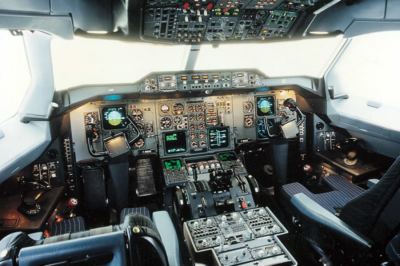

A300 is not fly by wire. It has no flight envelope protections.
Its old school, the current Airbus FBW system with all the envelope protections was sort of fitted to a few of them towards the end but it didn't come in until the A320 in 1984.
Quick google and it turns out that they hit toga by accident probably because the Captain had been flying 747 before and the AP didn't disconnect properly which there was a fix for already released but CA hadn't performed it yet. Funny actually because we spotted the same issue in these threads with the MAX and it got flagged to EASA and Boeing are having to fix it. If it wasn't for the two crashes they more than likely would have spotted it and also put the fix through the same way.
Every single aircraft type in operation today has had a pilot take them into the ground when the aircraft is fully serviceable through not following SOP's or loosing situational awareness.
Here is a A300 cockpit.
