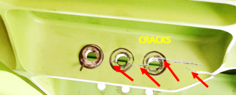

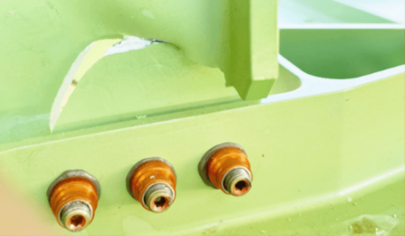

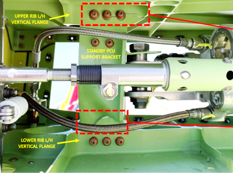

The idea that the bracket died of natural causes is inane. I hope they have more than that.
Aviation Investigation Preliminary Report said:
The captain said that while reviewing the logbook before the flight, he noted a previously recorded yaw damper discrepancy ...
Three aircraft were observed to have small rudder oscillations without associated rudder control surface movement ...
These quotes are red flags but are easily glossed over in the report. It seems a stretch to suggest a wind gust or other weather event caused or initiated the damage seen in the the photos provided in the preliminary report. Was there slop in the bracket holes?
If my rudder pedals were moving uncommanded on the A220 I would be grounding it.
And it would be written up in such way that they would be needing airbus to give a procedure release. Plus coms with chief pilot and tech pilot immediately.
Be interested to see what previous techlog entries were on the subject.
The natural causes is straight out of the old Boeing incident manual.
I suspect it is a everyone has messed up incident.
They are lucky it didn't turn into a fatal accident with a compromised tail.
