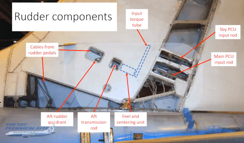

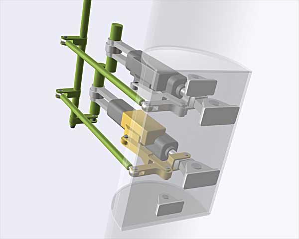

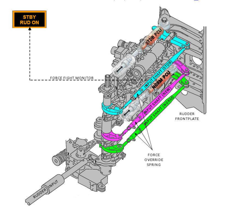

I'm trying to understand the rudder components and came across these OLD schematics and photos (YouTube video). I don't know how newer model components depart from the old systems so I'm offering these as a start point. Please speak up if I'm off track. The damage in this incident is related to the Standby PCU which is the upper set of components. It looks as though the system is fighting itself to produce the amount of damage seen in the photos of the frame and bracket (posted above).

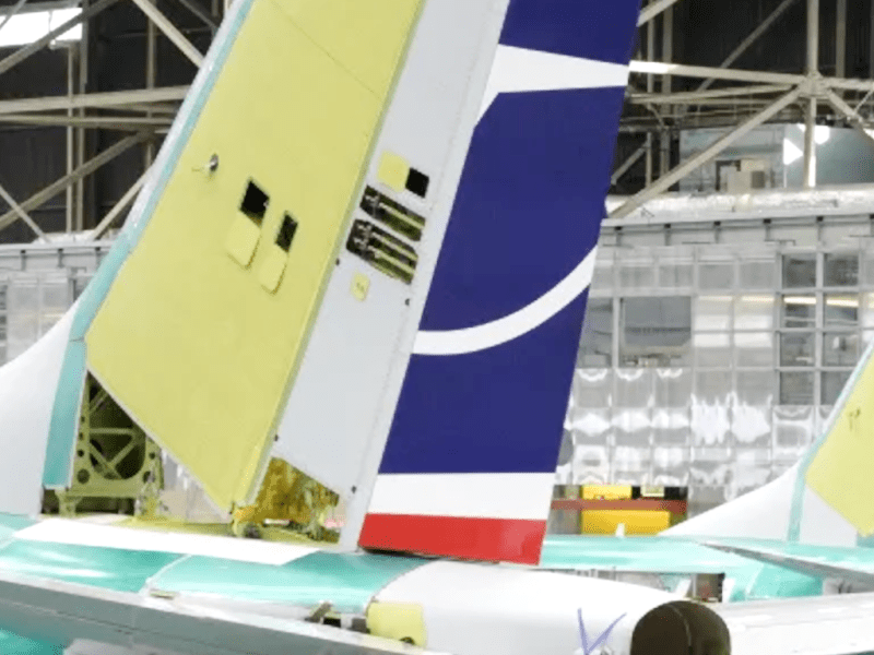

It looks like the rear fuselage is in place coming from Spirit: In any case this all appears to be within the vertical stabilizer and is essentially independent of the fuselage.

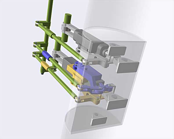

Old rudder system vs. new according to avstop.com, Sept. 14, 2000
Old
New
Dual main input rods seen here:
From Facebook:
Note that the input torque tube is not on the rudder centerline (FWIW), and from above, the forward connecting points of the rudder pistons are not necessarily above each other (again FWIW).
I presume there is an attachment lug on the standby PCU support bracket that is hidden by the input shaft in the report images.

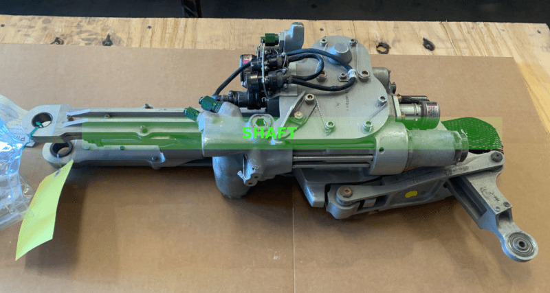

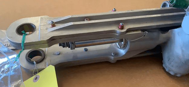

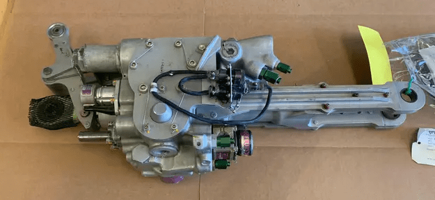

Here are a few images of a "737 PCU" offered on the web in years past (again FWIW). The hydraulic fittings aren't oriented as I expected but the images offer a general view of how I imagine the units to appear.
THESE UNITS MAY BE OLD OR NOT THE CORRECT ITEM - USE YOUR DISCRETION BEFORE ATTACKING

So if I'm starting to understand the system, the standby PCU is one that the pilot can elect to turn on. It lacks protection from hitting the stops as the main PCU has so a gust of wind can throw the rudder from one extreme to the other and in such an event, the bracket can absorb all or most of the punishment, as can any other component in the many linkages. That makes sense now.

Part of what? The PCUs are installed in the vertical stabilizer; nothing to do with the fuselage.

They are in the bottom section behind the pressure rear bulkhead. Which is in the picture.
Zero clue about proper Airbus or Boeing old school
rudders.
Do know where that lot is on a 737. It used to need lifting gear to get it out of the rear bay with a team of 10 technicians.
"They are in the bottom section behind the pressure rear bulkhead"
Since there is continuing abuse of pronouns here, I have to guess you are referring to the PCUs. Proper use of proper nouns is better for clarity.
No, the PCUs are not behind the pressure rear bulkhead. The pressure bulkhead is roughly 5 feet lower than the PCUs are.
What is behind the rear pressure bulkhead is the horizontal stabilizer trim drive; neither are shown in the photo below.
