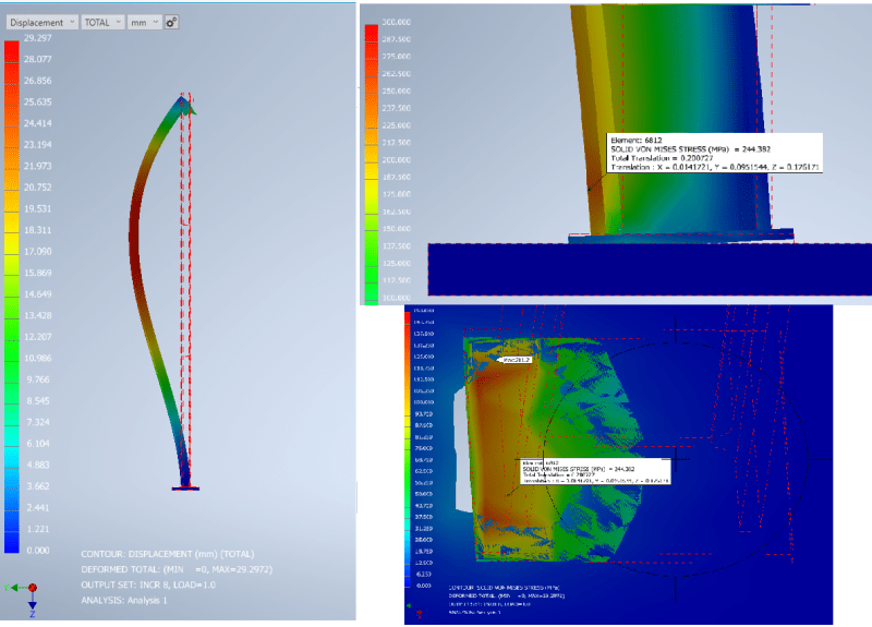

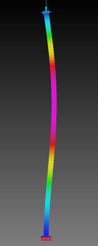

TEST APPROACH
-Non-linear plastic FEA analysis using NASTRAN
-Tri linear model of stress-strain curve used
-Iterative approach to converge on buckling solution (NASTRAN does have non-linear buckling analysis but not nonlinear PLASTIC buckling analysis)
-An additional lateral load of 1% of axial load was added to trigger the buckling. (This value is arbitrary but considered reasonable and conclusions not sensitive to this.)
TEST DETAILS
-Steel section: HEB160 S275 (EUROPEAN STEEL)
-Section length: 6600mm
-Minor axis translationally fixed, translationally fixed at the top, rotationally free.
-Base plate modelled in 3 ways; perfectly pinned; able separate but not slide AND; rigidly connected to foundation.
-Nominal mesh size - 50mm
CODE BUCKLING LIMIT:
Ncx = ~780kN (without any capacity reduction factor, both codes AS4100 and Eurocode within 2%)
FEA RESULTS
PINNED: Ncx = ~800kN
BASE PLATE (with sepparation): Ncx =~1150kN (equivalent le = 0.83)
BASE PLATE (RIGID): Ncx =~1150kN (equivalent le = 0.83)
As can be seen no discernible difference (<1% tolerance) between the rigidly connected base plate and a base plate with no uplift restraint.
CONCLUSION
In some/many circumstances it is not unreasonable to consider a typical column and base plate arrangement as 'fixed' for consideration of its buckling effective length. Without doing exhausting further testing I would suggest that this is reasonably representative for columns of 'intermediate slenderness' where inelastic buckling dominates.
ADDITIONAL TESTING
I was a little perturbed by the lack of discernible difference between a rigidly fixed base plate and one that is able to separate from its support. I hypothesised that this was due to inelastic buckling dominating before any appreciable rotation could occur at the base. This was tested by doubling the length of the HEB160 to 13200mm. To summarise this additional testing:
PINNED BASE = 275kN (Unreduced capacity in code 250kN)
BASE PLATE ON SURFACE = 460kN (equivalent le = 0.77)
FIXED BASE PLATE = 500kN (equivalent le = 0.74)
It was satisfying to see that for more slender columns the back calculated effective length approached the theoretical Euler elastic theoretical length. It was also satisfying to confirm that a fully fixed base base does exhibit better performance (as expected) compared to a separable base plate.

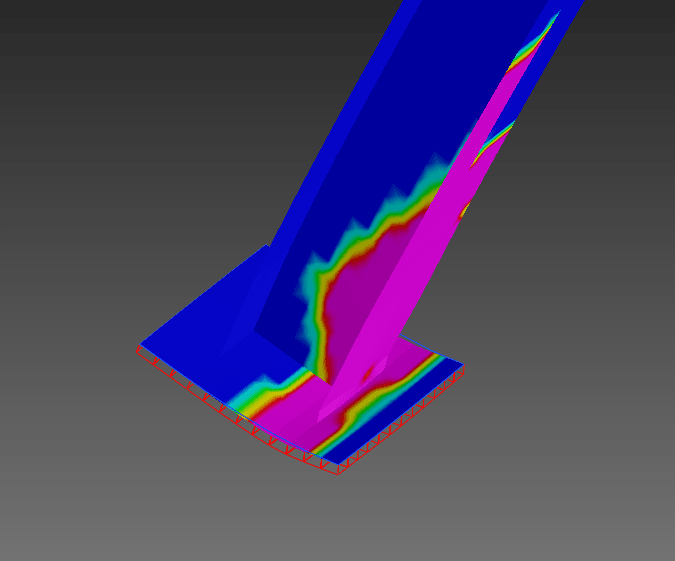

And here is a pretty FEA picture to keep everybody happy:

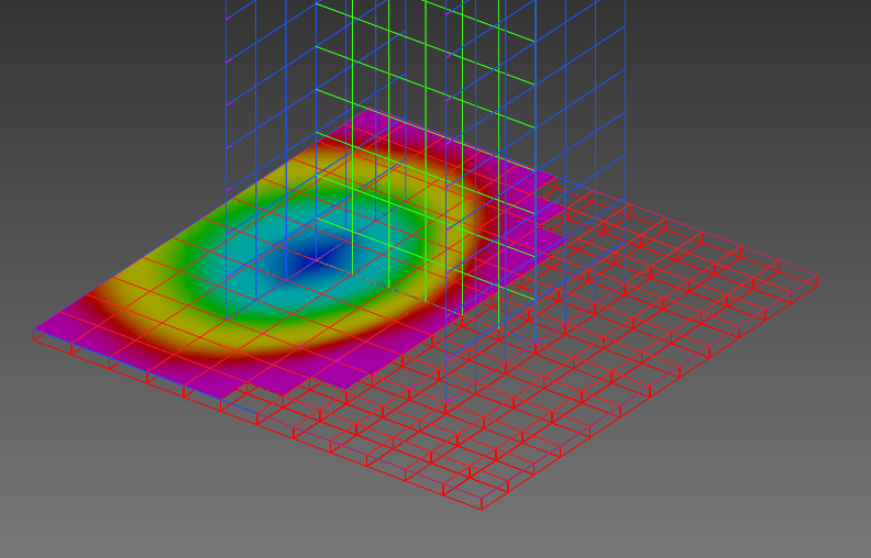

I was curious to know how this would behave if we delete the anchor bolts altogether and just rely on the baseplate supported in compression only.
Initial out-of-straightness was taken as L/200 = 33 mm; elastic - perfectly plastic material was assumed with 275 MPa yield strength; stiff compression-only support under baseplate.

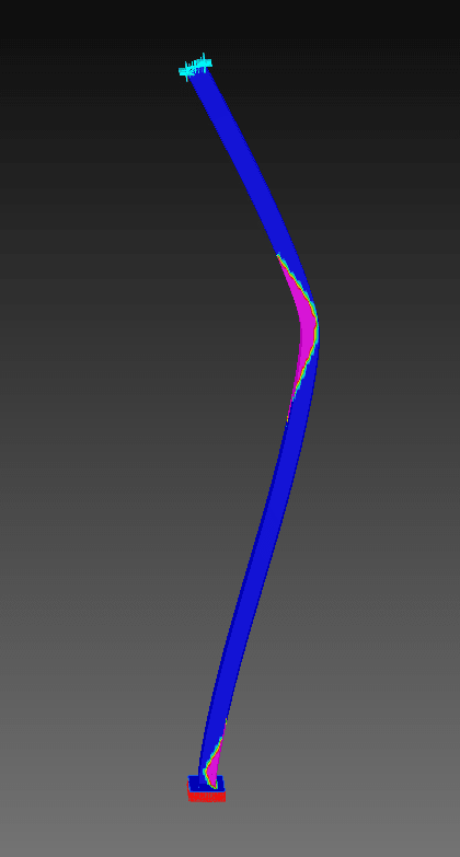

Below is showing the deformed shape for a load of 800 kN, close to the point of buckling. You can see that the base is fairly well vertical.
Contact pressure under baseplate at 800 kN load is shown below, indicating almost full contact.

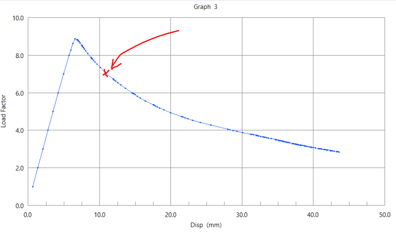

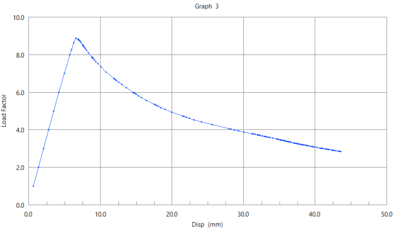

The ultimate buckling load is about 887 kN, which is quite a bit more than the code-based buckling load of 780 kN stated by OP, and implies an effective length factor in the order of 0.9. No doubt with anchor bolts, this would be closer to 0.8 as others have stated. The anchor bolts do not see any tension until well after the peak load is reached, so the 0.9 effective length factor would probably apply even if bolts were added in. Note that load factor of 1.0 below is equivalent to 100 kN force applied.

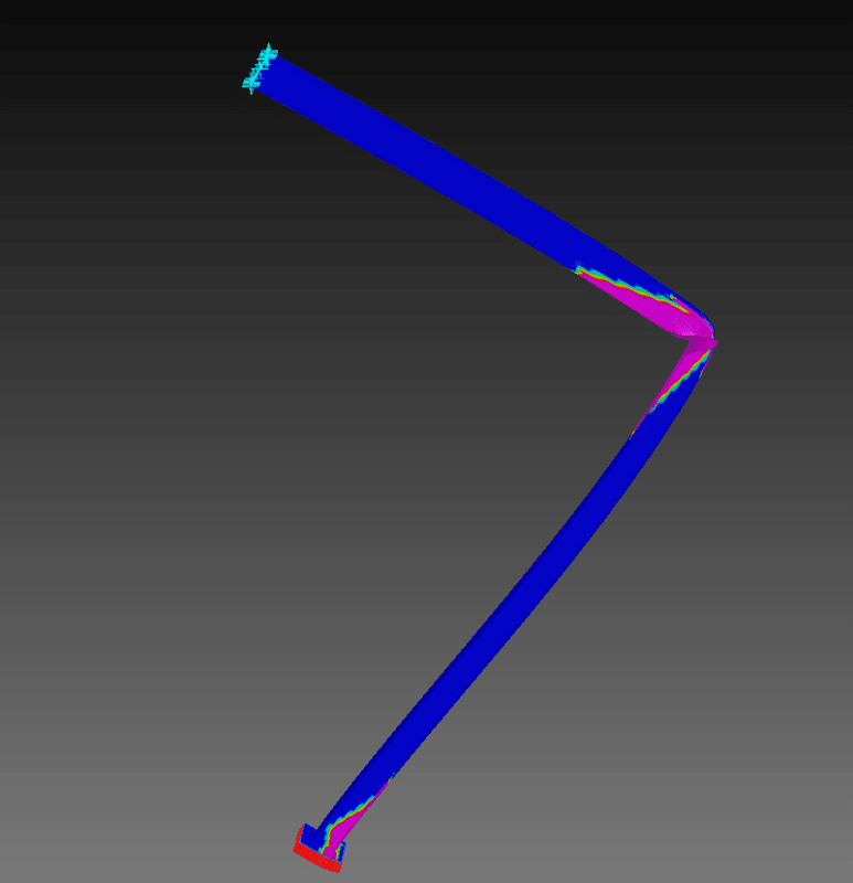

Even well past the peak load, the baseplate is able to provide almost enough rotational stiffness that a plastic hinge would form through the column there, but the bending strength of the baseplate itself seems to be limiting this. Below areas shaded in pink are showing the yielded regions (displacement scaled up 10x).
However ultimately the column forms a plastic hinge near its mid-height (displacements scaled up 10x).

What's the deflection of the baseplate at the locations where the "minimally effective layout" anchor bolts would be? Essentially the center of the plate if using only two anchors as shown in human's OP photo #2. Ultimately, what would the tension load on the anchors be due to prying/rotation prior to column buckling (and beyond). Assuming 3/4" dia x 12" heff anchors I suppose. It looks like there is still compression under the plate at those anchor locations though, until post buckling - so, zero? If so, does this further the current theory regarding contact stresses under the column flange/web intersection being the primary reaction providing most of the "fixity", as it were?
It looks like the results here would be pretty sensitive to the column section properties? Shear deformation in the web specifically. But less so than baseplate properties which are variables in the joint stiffness?
(Note all of the above is considering the anchors do not have a standoff. I.e., tension only.)
@dold up until the point of buckling - zero upward deflection of the baseplate.
The middle part of the baseplate only begins to lift up where I've shown on the graph, so I guess the anchor bolts would not be engaged until this point is reached.
Thanks gusmurr. For following up on this. I'd like to point out that my model also didn't have anchor bolts. (I did try having them in but didn't see any change in behaviour at the initial length.)
Thanks for providing the extra information regarding the contact patch. That is good work and something that I should have included.
If I get time I might see what my buckling behaviour is with that same imperfection as you used. I'd argue that a 33mm imperfection is pretty severe and likely accounts for the lower buckling loads that you have vs mine and vs code at an effectively length of 0.85.

Yes. Zero load on the anchors. When I doubled the column length to 13200mm. I did notice a slightincrease in capacity between a truly rigid connection and the non anchored connection. So presumably there would be some uplift on the anchors bolts just prior to buckling. I haven't measured this. Also not that 13200mm long HEB160 is a ridiculously slender column.
human909, I agree the L/200 is a large imperfection. I think L/1000 is normally what is produced in practice and what the steel fabrication standard allows for. The L/200 was taken from AS 5100.6 4.10.5 and I believe also accounts for the effects of residual stresses in the hot rolled section (so it's an effective imperfection). I believe this approach tends to give somewhat conservative results. I'm sure that the real effective length factor is closer to 0.85.

For what it is worth, I tried you 33mm imperfection and got around 940kN buckling. That is more deviation that I would have expected, but not beyond the realm acceptability given the many differences in our models. I tried fiddling around with mesh sizing (reducing it) and the stress-strain curve (matching it to yours) and that dropped it to 920kN.

My contact stresses were similar. But Gusmurr has done a better job of presenting the information here so I didn't feel the need to repost more of the same.

Gusmurr, would you be willing to post the values of deflection vs load on the ascending part of the analysis? I just noticed that your graph looks quite linear by eye. Also base moment and base rotation for the same load steps.
Human, similar request if willing.

According to code we get 440kN for ke=1, 485kN for ke=0.85. And 620kN for ke=0.7 (Euler theoretical effective length for fixed-pinned) AND a fully rigid moment connection at the base.
I get 590kN for the FEA modelled case. So only 5% less capacity than for a fully rigid connection compared to code.
I get 600kN for the FEA modelled case RIGID case. So matching code and only 2% more than the non rigidly connected baseplate.
So for all intents and purposes we still have a connection that is behaving more like a rigid connection than a pinned connection.
Again PLASTIC buckling is dominating these results so that is part of the reason why the lack of positive base fixity has much affect.
Here is the model at the limit of buckling. Deflection is heavily exaggerated.
