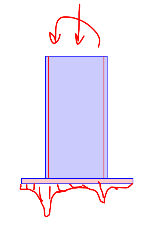

Human909, does the structure you're reviewing have done kind of knife edge loading?
Centondollar, what order of magnitude is the eccentricity you're worried about? What's stopping you from using the code value in the worst direction?
100mm wide bearing plate completely central to column. With another column above transferring the axial loads again central. Geometry would imply <20mm eccentricity.
(Though I'll likely insist on a HEB180 instead of a HEB160, I like to sleep comfortably a night.)
Just saw human's latest analysis. I'm taking the load eccentricity to be 100mm off the flange, so 180 off centroid. That translates to 90mm approx at the base for rigid assumption, plus any non-linear amplification. Could you please extract base moment at buckling point for the fixed base case and the situation being discussed? It still seems to me that the relationship between the moment that the clamping can develop and what full rigidity demands is what determines where the answer sits on the Euler spectrum.
BTW, my objection to Euler is because it can't handle the variable base rigidity. Or, at least, doubtful anyone has bothered to modify the Euler analysis for this situation. I'm not objecting to its lack of physical imperfections (any more than usual - I think Euler's prominence in teaching actually makes it harder to learn stability design).
I explained the mechanics of the problem (if it is to be treated as a "footing" problem or a "post-tensioning" type problem), and in that explanation I hope I made it clear that it is not the order of magnitude or direction that is the issue. The issue is in the mechanics, not in code values (which are not necessarily realistic or generalizable, to the detriment of all who are required to cite code) for eccentricity.
Again, how do you propose that the precompression from eccentricity (P*e/W) is to be controlled such that it follows the change of direction of lateral load? This is a requirement for the precompression (and fixity without resorting to bolting) to be guaranteed.

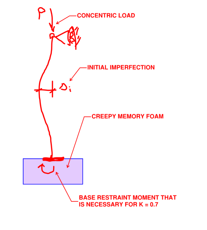

Centondollar, I think I follow your argument now but still disagree. Rotation of the column base is not 'free' as in an ideal pin. It is accompanied by a bending moment in this case, up to some point. I think it's fair to say there was an implicit limitation of this discussion to columns with minimal external moment at the base, so the bending moment that can develop is available to resist non-linear effects related to axial compression. The moment will develop in the necessary direction without external interference.

KootK said:
I myself have availed myself of base connection stiffness on a few renovation assignments (for buckling restraint)
Good to know there are other engineers out there taking advantage of the base connection stiffness out there. Some of the respondents here seemed to have reacted to me like I have three heads by even suggesting the possibility.
KootK said:
creep. The grout bed, the concrete, the soil, and the bond on any active tension anchors will tend to creep over time, even at low stress levels. Such creep would tend to dissipate the base restraint moments that one is hoping to mobilize for a K=0.7=ish column design. The impact of this would be affected by the rate of loading of course. As such, I get less comfortable with this as dead load becomes a larger portion of the total load.
An interesting factor. And something to think about if you are choosing to walk the line of unconservatism. But is it really that influential? You'd need some pretty eccentric loads to cause creep. And the same creep would be appearing on regular pinned base plates that we have all over the place in our structural steel buildings. If creep was a factor we'd be seeing our buildings all the time.
I don't know, and that's the problem.
I disagree. Consider:
1) Creep in concrete occurs at even very low levels and;
2) The base moment that concerns me requires no eccentricity of load at all. Rather, it would be based on the real world / moment amplification model of buckling (as opposed to bifurcation) wherein the column possesses imperfections that just grow over time. See the sketch below, imagining the concrete to be something like the memory foam that they make those sweaty mattresses out of. I see all real world base conditions as less creepy version of this. In this case, I feel that:
a) K = 0.7 would be reasonable for instantaneous loads but;
b) K = 1.0 would be appropriate for slowly applied loads as the base rotational restraint would tend to diminish with creep.
I don't think that's true because:
3) The overwhelming majority of columns are designed K=1.0 and, so, do not depend on the presence of base rotational restraint.
4) Where you get serious, deliberate base moments, as with some moment frames, the peak load cases are usually transient and short lived and, thus, not punishing from a creep perspective.
10 MPa sustained stress gradient / 35,000 MPa modulus * (1 + 2.5 creep) = 0.001 strain gradient due to sustained load.
10 MPa / 35,000 = 0.0003 strain gradient due to short-term load.
Total strain gradient = 0.00013.
25 mm grout.
Estimate 100mm/2 effective compression depth in footing before the load spreads out.
0.1 mm differential displacement / 160 mm section depth = 1/1600 slope. That's not stopping me assuming I've already gone to the dark side of K<1.
But then there's the soil. And flexure in the footing. And the fact that, as shown below, the strain under most column base plates will be highly localized and nothing like a uniform gradient.
The soil and footing are common to the case of a conventional rigid connection. If we can't rely on them then the discussion is over AFAIC. I think they're part of the reason we use K = 0.7 or 0.85 instead of 0.5 and 0.7.
Creep will even out the stress in the grout. We get the good with the bad.
