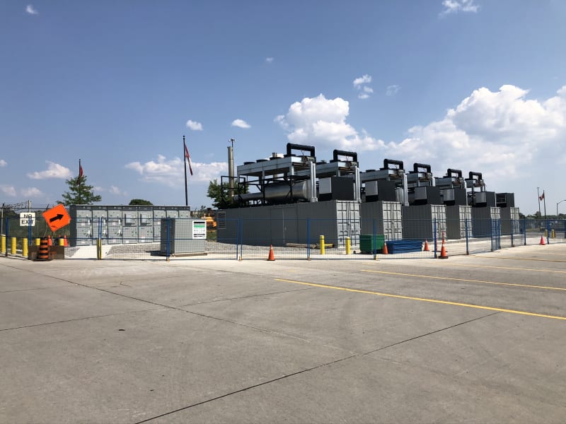

As an amusing case to me, the City of Toronto TTC is switching to electric buses. What they never mention in all the media hyping for this green incentive is that the buses are being charged with NG generators. Toronto Hydro doesn't have the grid infrastructure to supply the necessary charging power to the bus garages. 6 x 1.2MW generators were installed at the bus garage being used as the initial test site and similar installations are being planned at other bus garages. Shortly after the generators and switchgear was placed, they planted a row of closely spaced evergreen trees/bushes to hide the equipment from the public view when driving past the garage. The switchgear did have utility tie breakers, but there is no current plan to use them. More likely, they will connect to co-generate back onto the grid.
Here's a picture shortly after the generators were put on site before the trees were planted. I didn't fine one showing the trees, but I didn't look too hard.
Still, even though an electric bus is currently about $250k more than a diesel I do believe they will payback in operating costs and they will be more green than a diesel bus despite their dubiously marketed green-ness.

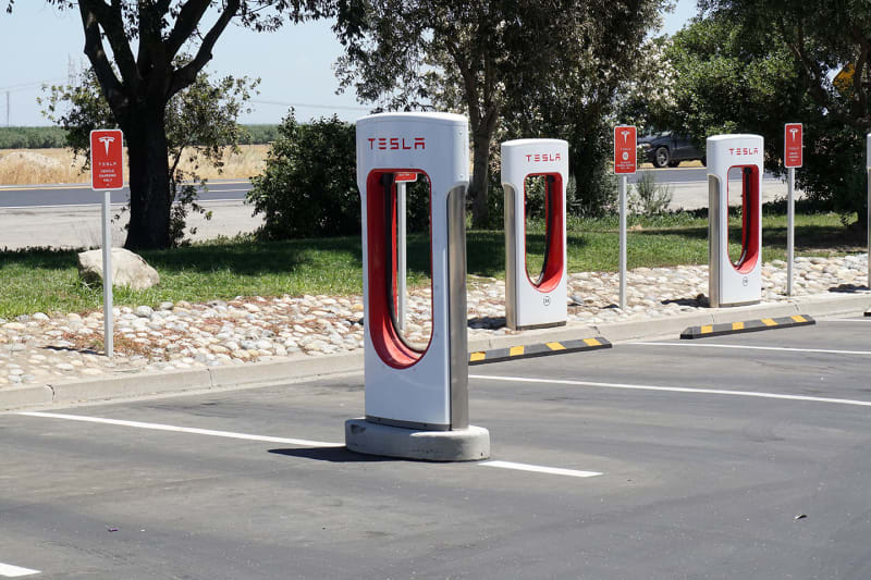

My son's condo just upgraded to having charging cables for all parking spots, EXCEPT HIS, because it's not near a wall [hairpull3][curse][flame]
TTFN (ta ta for now)
Well duh, how would it stand up? Is is just supposed to float there?
For that to work, they'd have to invent some sort of "pole" or something and I just don't think we're quite there yet....[banghead]
Andrew H.
Tesla recharging stations are free-standing:
